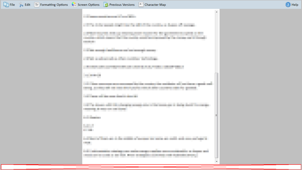

Just been to collect the exam scripts and one of our machines has the big red X thing again.
We're not on the absolute latest version (some of our kids using it are very highly SEN and any noticeable change will negatively impact them, so don't want to risk updating until after the exam season) but we're on one of the more recent builds. .exe says it's 2.1.3.0
[ATTACH=CONFIG]49208[/ATTACH]
The crash sometimes happens in older builds when the timer clock tries to return the correct date time.
This was changed in later builds by using infinite looping and stop starts correctly for the date/time in the status bar.
Please try v2.1.4.5 latest and the problem should disappear.
Yea, got the same issue the other day in an exam. Wanted to use a version I know has been working really well so haven't updated in a while. I'll update ExamWritePad for mocks next year. Just want to get the main exams out of the way.
