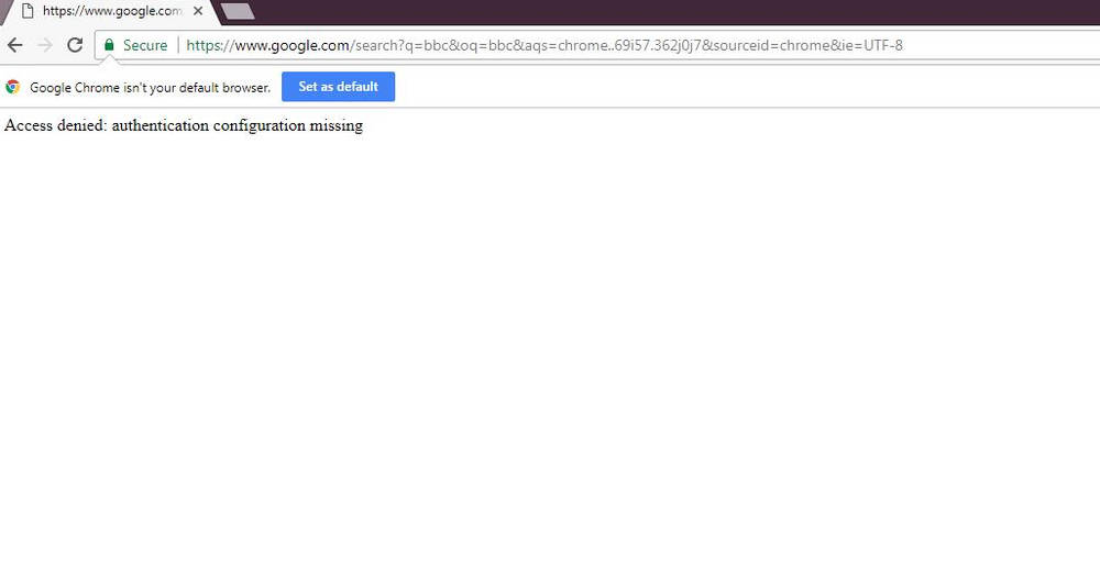

We are currently in the process of upgrading a ICT suite from HDD's to SSD's and the machines that we have upgraded seem to be giving us issues with getting onto the internet for the users.
Whenever a user logs on, they unable to access the internet as it says 'access denied: authentication configuration missing' in Chrome, however when the same user logs off and back on again, the internet seems to work completely fine. It's as if the machines are logging in way too fast and not picking up the right proxy policy for students, hence no internet. We use a proxy server, in which students go out on port 800.

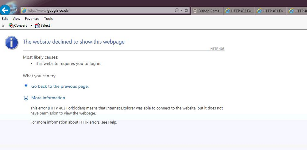

We are using registry key in HKEY_USER via GPM. The three reg keys we use is proxy enable, proxy override & proxy server. Been using this for years. Only until we've upgraded our machines to SSDs they are giving us this issue.
We've already made that change "always wait for the network at computer startup and logon" on GP but still no luck. It's literally affecting only a handful of machines we've upgraded to SSDs.
Internet doesn't work on any web browser (have tried IE and chrome). We currently use roaming profiles.
