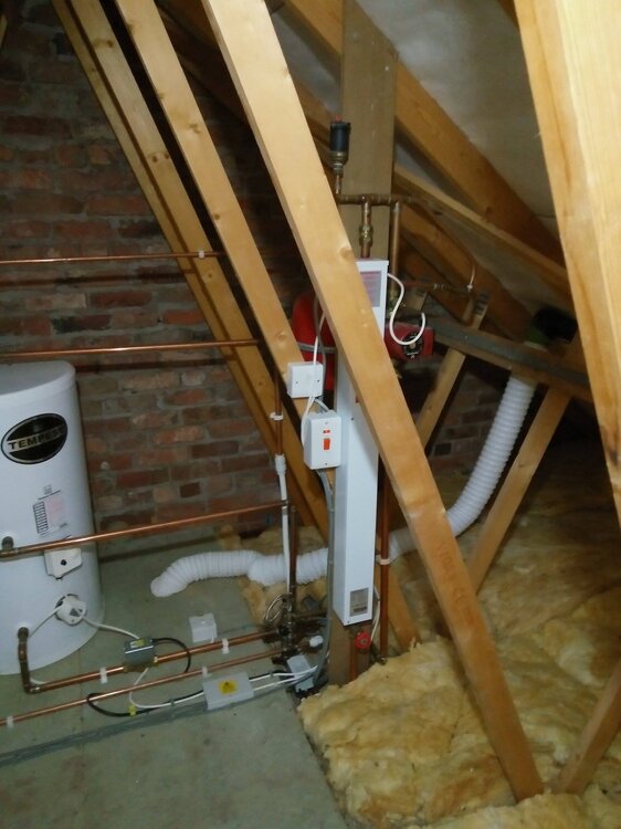

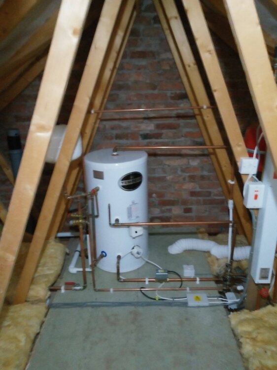

Thanks for all the help guys and all the responses it's most appreciated. Here's a picture of our setup, it's not the best picture I'll get a better one tonight if these aren't good enough!! :)
14453937_895245767276513_1330970753_o.jpg 14454092_895245707276519_1321986350_o.jpg
It looks like there's a further white tank to the left - possibly another expansion vessel - would be useful seeing that as well when you get a chance for a decent picture.
That looks like expansion for the water heater looking at the pipe route.
Its worth mentioning that expansion vessels have an 'inner tube' inside them that requires being inflated. That can play havoc with combi boiler water pressures.
I wonder if that would affect your water heater? Hhhhmmm.
Edited by mikkydoos
The vessel is usually in two halves separated by a rubber diaphragm. Red expansion vessels are for hot sealed systems, white and blue are for open systems often with potable water.
In OP's system we can see from the picture that the hot water is being done by an immersion heater in the big tank and immediately above the immersion looks like some kind of thermostat (?). So if there is a problem with hot water, it is going to be reactively simple (immersion, thermostat or the controller which switches it on).
