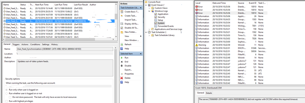

Hmmm, just to come back to this. Windows Insider is on my machine as im using EDU however we have LTSB2015 deployed out to the school and those machines don't have the Windows Insider Service listed so im wondering if something is calling that service and crashing as it doesn't exist.
We are looking at deploying LTSB2016 out soon.
Still grasping at straws with this problem and still continuing to run Impero but ive seen something on our machines in Task Scheduler which might point us in the right direction. Ive checked the machine which had the problem yesterday and seen the attached image. Is it a coincideace that the logs from event viewer marry up with the User Feed Synchronisation task?
Ive checked a few other machines around school and some machines have loads of entries of this user feed sync service.

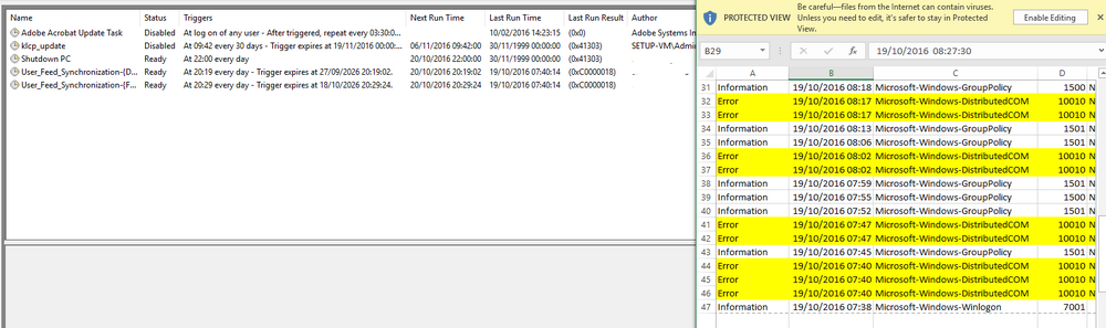

Just had another machine with the black screen problem.
Got hold of the local Impero folder on Program files and checked the event log and the schedule tasks to find the attached.

I have only seen this issue on 1607.
We are also running Impero, but I don't think it is related as it often happens on machines before Impero is installed and I have seen the problem occur on brand new home builds, including my own!!
The problem seems to occur after Windows Updates has been run or while they are being applied.
The DCOM event errors are written to the event viewer during the black screen state.
