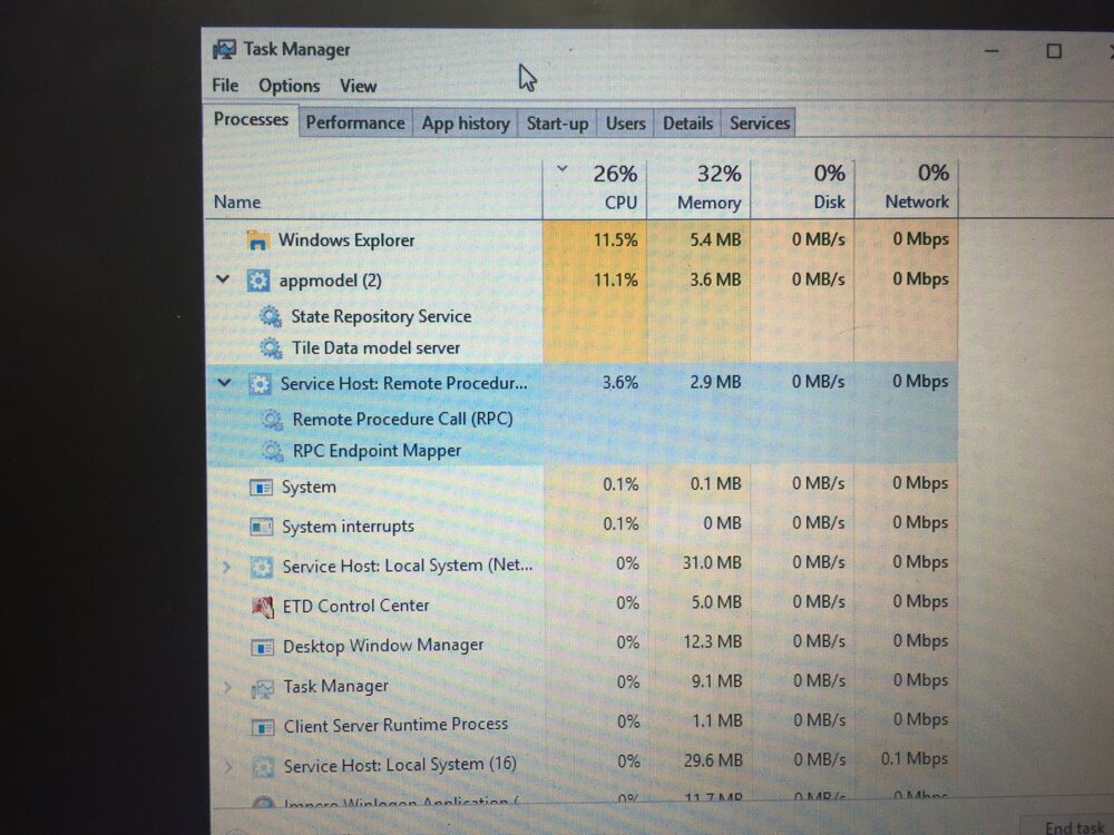

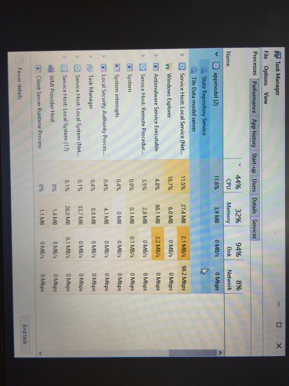

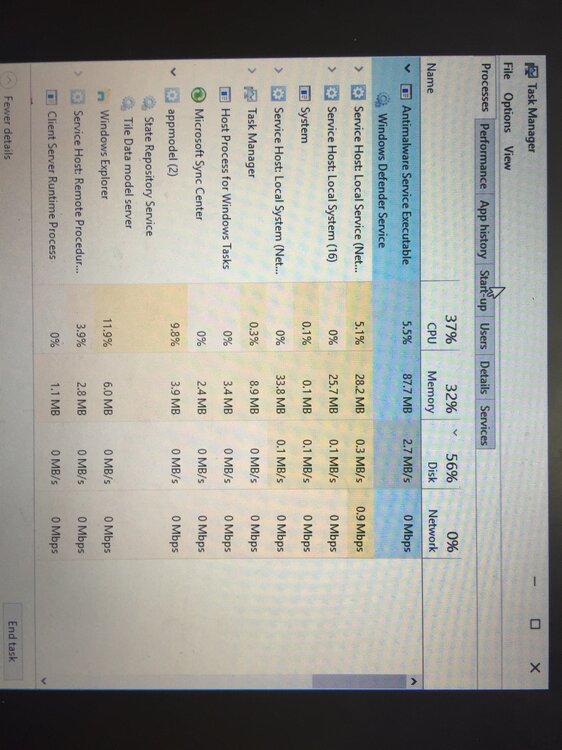

Just had 3 machines do this today, all after running the latest rollup update (KB3197356) - these are Stone machines albeit the oldest of the desktops I have running here (Core 2 Duo's, 120GB SSD, 4Gb RAM).
I'm just trawling the event logs at the moment when a student logged. Errors of note in the System log are:
Event ID: 7009 -
A timeout was reached (60000 milliseconds) while waiting for the CDPUserSvc_37cd7a service to connect.
Event ID: 7000 - The CDPUserSvc_37cd7a service failed to start due to the following error:
The service did not respond to the start or control request in a timely fashion.
Event ID: 10010 - The server {D63B10C5-BB46-4990-A94F-E40B9D520160} did not register with DCOM within the required timeout.
The last error shows up 4 times in the window that the student logged in with.
Can this really still be a Microsoft issue after all these roll ups or something else? - as I said before, we run Impero here like many others who seem to be having similar issues here; could this be the issue? I've lost faith in Impero as of late because of the numerous issues we've had (and would appear others are having on the later releases).
