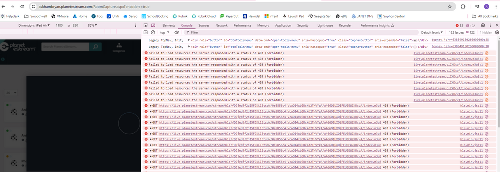

The browser is chucking this: live.planetestream.com is in a "Do not Filter" Rule, the URL list is in an auth bypass and SSL inspection bypass too. -

We are a Planet E-Stream and Smoothwall customers. All elements of Planet E-Stream work over smoothwall with the exception of watch a live stream. It just get a buffer wheel and the stream never comes through. If i record the live stream i can watch it back in planet e-stream via smoothwall i just can't watch it live. I have added an any,any,any,allow firewall rule for my Laptop IP and added a guardian source exception and this has made no difference. I have tethered my laptop to mobile data and the live streams work, and similarly mobile phones that play the live streams stop when added to an SSID that behind the smoothwall. Surely adding the allow all firewall rules and guardian exception should solve this? Im out of ideas when ive kicked the biggest hole possible in the smoothwall and its still doesn't work. Any ideas?
