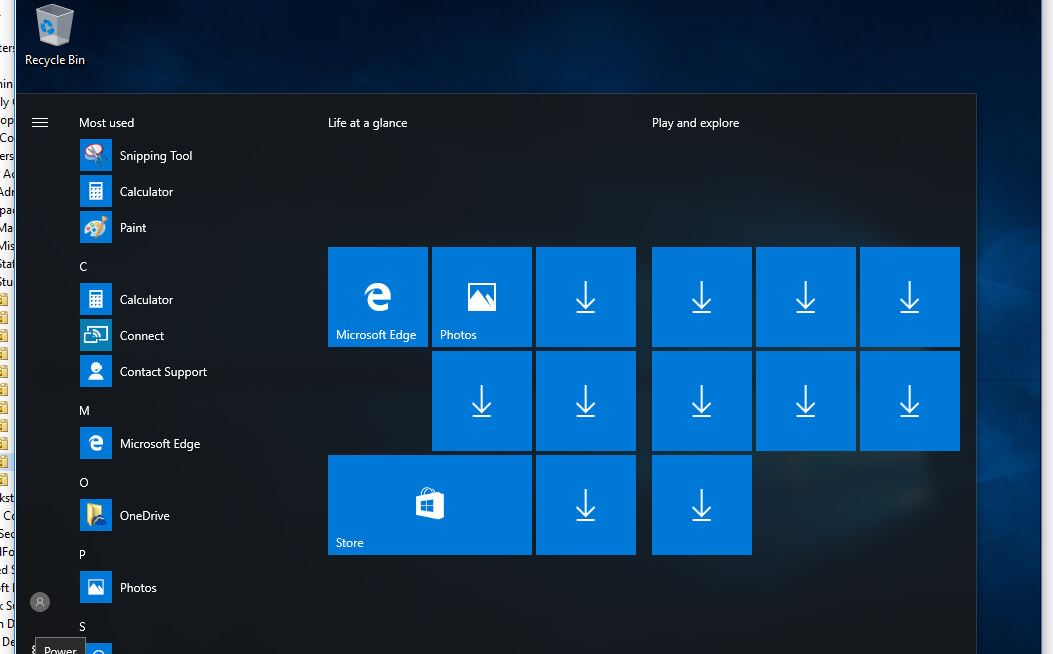

I have created a PowerShell script you might find useful. It's based on the script I linked to above, but I have modified it to work with an offline Windows image (i.e. the install.wim from a Windows 10 ISO).
All you need to do is to save it in the same folder as an install.wim, add or remove any apps you want to keep from the section highlighted in red (use the DisplayName, not the PackageName) and then run the script from an elevated PowerShell prompt.
What you should end up with is a Windows image that only contains the apps you want. I have tested it with several of the Anniversary Update builds and it works perfectly with those too. :)

The section highlighted in purple is optional, although it's probably worth keeping so that the "DisableWindowsConsumerFeatures" registry value mentioned in the very first post is added and to avoid the issue described in post #11. The other three registry values above it can be deleted if they aren't required.
Removing the apps offline has several advantages...

This looks like it will achieve exactly what I want it to, but I'm struggling a bit because I'm a Powershell noob. I can follow what's going on - but don't know enough to amend it.
It's erroring out at:
ForEach-Object {
# Mount image(s)
"{0} {1} {2}" -f "Mounting image", $($_.ImageIndex), "`n"
Mount-WindowsImage -Path "$ScriptDir\Mount" -ErrorAction Stop -Index $_.ImageIndex -ImagePath $_.ImagePath | Out-Null
[/Quote]
with the message:
ForEach-Object {
Missing closing '}' in statement block or type definition.
+ CategoryInfo : ParserError: (:) [], ParentContainsErrorRecordExceptio
n
+ FullyQualifiedErrorId : MissingEndCurlyBrace
[/Quote]
I presume I need to put a "}" in somewhere, but could do with some help please :)
What I've done so far:
Extracted the install.wim from the sources folder of a Win 10 Edu iso and placed in a directory that I created for testing this. Copied the text from @Arthur's post into a txt file and saved as .ps1 file. Upgraded Powershell to v5.0 on my Server 2012R2 machine. Run the script while logged in as an administrator. I guess I've sorted the permissions and pre-requisites to get the script running, so am in an optimistic mood at the minute.
Thanks in advance...
Download the attached text file to the same folder as your install.wim, rename the extension to .ps1, edit the list of apps you want to keep on line 31 and then run the script from an elevated PowerShell window. :)
Invoke-RemoveBuiltinApps.txt
Thanks @Arthur
Definitely making progress. It's now complaining about the version of DISM - I put just the install.wim and the script in a folder, so I guess that putting the extracted contents of the whole iso and then putting the script in the sources folder will pick up the correct version. I've run out of time just now, but I'll have another go over the weekend.
I think it might be worth running the script on Windows 10 rather than Server 2012 R2.
This worked perfectly thank you. I now have a PC with Windows 10 edu without junk installed!
