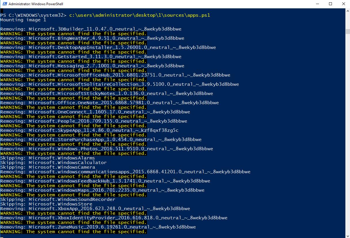

Just tried this on the latest (November 2016) Edu ISO, but I get:
Does this latest ISO not have these apps in it? Or more likely, is something else amiss? The same Powershell script worked on a slightly older Windows 10 Edu ISO.
[ATTACH=CONFIG]41742[/ATTACH]
the numbers at the end change so you need to redo the script and find out what the numbers now are
The script creates an array containing the current app version numbers (retrieved from the image), then removes them as listed - no need to change any version numbers in theory. That's why it's so much quicker than doing it manually. However, something else is playing up here.
Edit: just checked by running the script in sections. The apps listed with:
Get-AppxProvisionedPackage -Path "$ScriptDir\Mount" | Select-Object -Property DisplayName,PackageName | Sort-Object -Property DisplayName}
are the correct versions that the script then tries to remove, as I suspected. Still gives me WARNING: The system cannot find the file specified.
This is a fresh ISO downloaded from the VLSC. Have you tested with this one @Arthur ?

No, November 2016 (January 2017 isn't showing on VLSC for me). The other thing that may be slightly different is I'm using the English International version, but the script still sees the apps correctly.
I had exactly this issue, but assumed I was doing something wrong... I was using the English International version - I may have used the English US version before - I'll have to check later.
It worked fine for me at the time, but I think I will do some more testing. :D
Are you using the Jan 2017 1607 ISO now?
I had it running successfully on 1511. I encountered the problem when using the November 2016 release (the one that became available on VLSC in January '17).
Edit: I was running this on a VM
Edited by jmak
Woops, then yup it is that version. When I run the script on that version, but the US English ISO this time, it works. That would suggest either an issue with version numbers of the apps somehow, or the English International version doesn't come with these apps installed somehow (I haven't installed it to check). Worth noting anyway - the script doesn't (at present) work on the English International version of the November 2016 ISO/wim. That's a pain, as I don't want to roll out the wrong localisation as it bugs me, and I don't want to roll out the apps in the images either.
I have done some more testing (and googling) and it is looking like it's a bug with Microsoft's .wim images rather than my script. :(
If you take a look in the DISM log when removing apps from the en-GB (International) image you will notice the following errors.
[13564] ImageUnmarshallHandle: Reconstituting wim at D:\W10\Windows 10 Education (x64, en-GB) - 2017.02.26.wim.
2017-02-26 09:01:33, Error                 DISM   DISM Appx Provider: PID=30032 TID=14064 [color="#FF0000"]Failed to get staged packages for package[/color] 'Microsoft.OneConnect_1.1605.17.0_neutral_~_8wekyb3d8bbwe'. - CPackageAdapter::CreateForRemove(hr:0x80070002)
2017-02-26 09:01:33, Error                 DISM   DISM Appx Provider: PID=30032 TID=14064 [color="#FF0000"]Failed while initializing package adapter for package[/color] 'Microsoft.OneConnect_1.1605.17.0_neutral_~_8wekyb3d8bbwe' - CAppxManager::RemoveAllUserAppx(hr:0x80070002)
2017-02-26 09:01:33, Error                 DISM   API: PID=13564 TID=25240 [color="#FF0000"]Failed to remove package[/color] - CRemoveAppxCommandObject::InternalExecute(hr:0x80070002)
2017-02-26 09:01:33, Error                 DISM   API: PID=13564 TID=25240 InternalExecute failed - CBaseCommandObject::Execute(hr:0x80070002)
When Googling the error code I found other people with the exact same issue...
https://forums.mydigitallife.info/threads/50572-MSMG-ToolKit/page30?p=1313746#post1313746
https://forums.mydigitallife.info/threads/50572-MSMG-ToolKit/page30?p=1313763&viewfull=1#post1313763
https://forums.mydigitallife.info/threads/50572-MSMG-ToolKit/page29?p=1312403&viewfull=1#post1312403
A potential solution might be to use the July 2016 v1607 ISO, integrate the latest servicing stack/cumulative update and then remove the unwanted apps. I am going to test this next. :D
FWIW, apps and version numbers are identical in both en-US and en-GB images so it's not that. :)
It actually worked! :D
