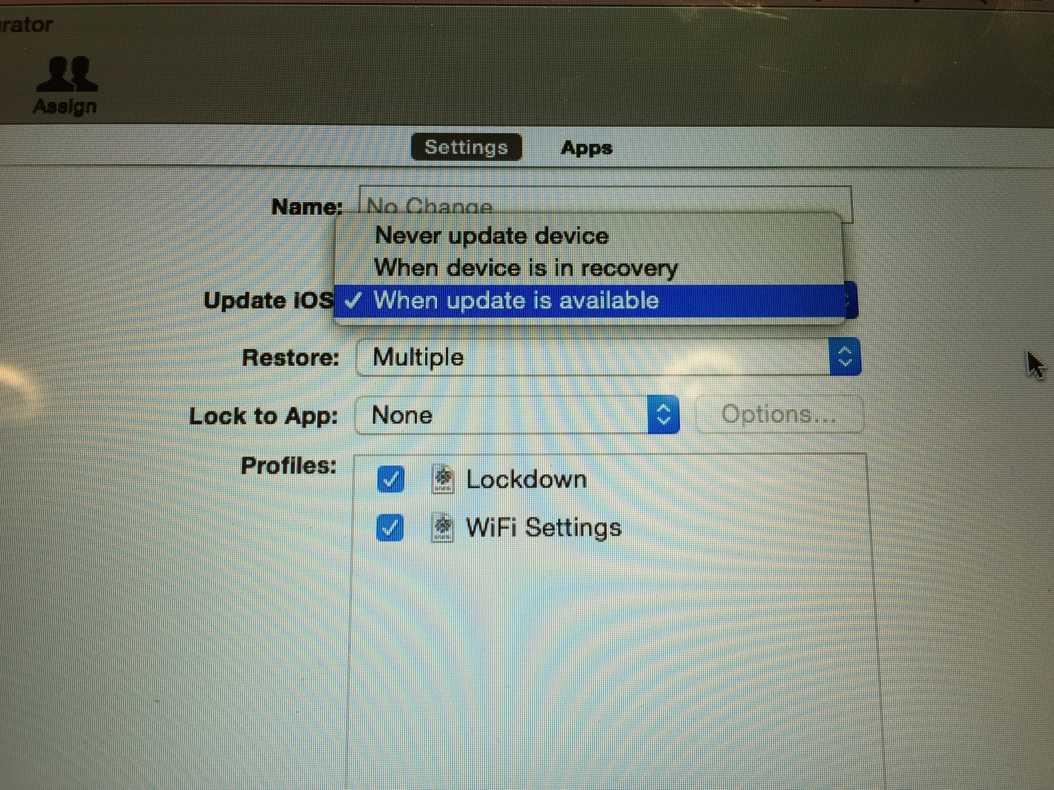

I always thought that the Update device in configurator was only an option that you could select or de-select, or at least that's what it is on mine

You've never used Apple Configurator with a custom iOS you previously downloaded from elsewhere....? Details below how to use this with Configurator
https://support.apple.com/en-gb/HT200241

That does the trick, thank you!
Never thought of doing it like that, I usually just browse to the path Configurator looks for IPSW's and place the file there. Not sure if that would have worked in this instance.

I've just had a previously supervised iPad returned to me as it had had a passcode added. I ran it through "Recovery Mode", connecting it to iTunes on my PC. This upgraded it to the latest IOS. Before connecting to the Mac with configurator on, I told it not to update the IOS in configurator, I then connected the iPad, it went through the supervise process and has come out the other side all done and ready to go back on to the trolley.
