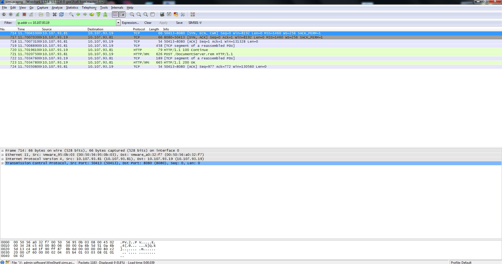

kennysarmy Posted August 5, 2015 Author Posted August 5, 2015 I worked out how to do a wireshark trace between the two IP's of the new and old server and these are the results. Surely there should be no such traffic if it's been setup correctly??
kennysarmy Posted August 5, 2015 Author Posted August 5, 2015 Also found this line in the trace: 710 11.697013000 10.107.93.81 10.107.93.1 DNS 85 Standard query 0xff1a A sims01-v.curriculum.local Why is the new server trying to DNS lookup the old SIMS01-v ? is this something being called by the software at logon - and with sims01 turned off it takes ages to timeout?
kennysarmy Posted August 5, 2015 Author Posted August 5, 2015 From the trace: POST /DocumentServer.rem HTTP/1.1 User-Agent: Mozilla/4.0+(compatible; MSIE 6.0; Windows 6.2.9200.0; MS .NET Remoting; MS .NET CLR 4.0.30319.34209 ) Content-Type: text/xml; charset="utf-8" SOAPAction: "http://schemas.microsoft.com/clr/nsassem/SIMS.DocumentServer.IDocumentServer/DocumentServerInterfaces#Ping" Host: sims01-v:8080 Content-Length: 572 Expect: 100-continue Connection: Keep-Alive SIMS01-V = is the old server...........this does not look right....

matt40k Posted August 5, 2015 Posted August 5, 2015 [ATTACH=CONFIG]31818[/ATTACH] I worked out how to do a wireshark trace between the two IP's of the new and old server and these are the results. Surely there should be no such traffic if it's been setup correctly?? It's DMS \ DocStorage \ Reports Only place you set the server is in the connect.ini, other then for DMS - that's within the db, tools > setups > dms or something like that
