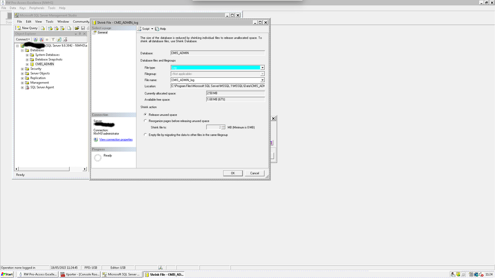

When was the last time you shrunk your SQL transaction log in the SQL management studio?
my boss says easter but is there a way i can double check whether the transactional logs were done or not and when?
You can see the size of the log file under "currently allocated space" if its too big, shrink it.
