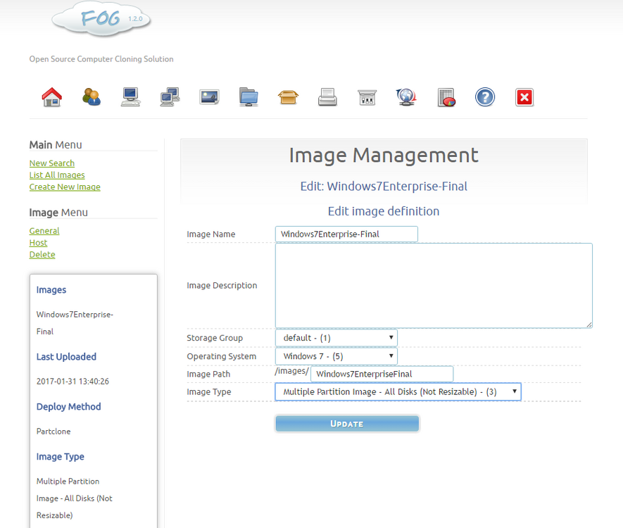

Hi, No, it doesn't even start to upload the image, I just seem to be getting an error; one of the errors are: *Preparing to send image to server. *Checking Mounted System...............Done *Using Image: Windows7EnterpriseFinal *Perparing backup location............Done *Looking for Hard Disks................Done *Using Hard Disk: /dev/sda An error has detected! No resizable partitions found. Computer will reboot in 1 minute. That's all I'm getting, and I get different errors each time I click on the 'Image Type', and select the different options. Please help, surely it must be something simple that I'm missing... The machines are band new out of the box, I've installed Windows 7 Enterprise on, I know there's two Partitions on there, there's a recovery partition, and then the C:\ drive... Could it be the recovery partition that's causing the issues? Thanks, Dan -

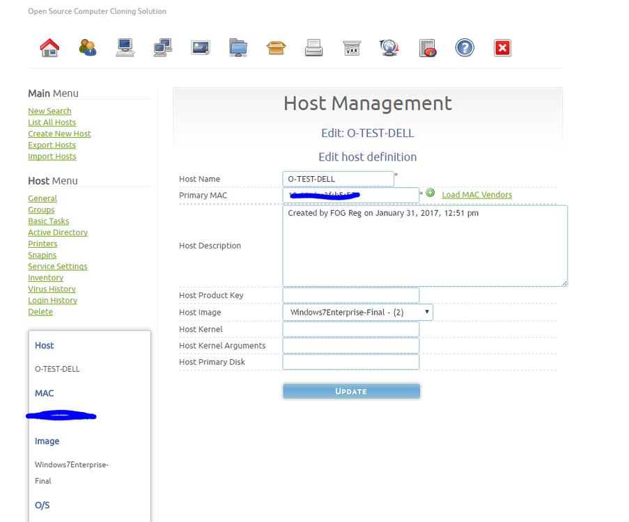

Hi, Yes, it boots to FOG Fine, and has been registered as I've said above. I'm just not too sure about how to upload the image to the server. I've registered the machine with FOG, and it appears under the 'host' menu, which is correct... Please see the two attached images... I've got the image ready to upload, it just won't get past the point where the screen goes blue and it begins the upload process. Dan -

Hello, I've managed to get FOG installed and finally working, went back to an older version... Now for some more help if possible, I've got X100 of the same machines Dell Optiplex 3040's all with 256GB SSD's - I've created my master image, and I'm now trying to upload the image to the FOG server. I've registered the machine with FOG, entered a host name etc etc. Back on the FOG console; If I go to 'Image Management', then create a new image, give it a name, the bit that I'm getting stuck with is: [TABLE=class: tablesorter tablesorter-default, width: 100%] [TR=class: alt1] [TD]mage Name[/TD] [TD][/TD] [/TR] [TR] [TD]Image Description[/TD] [TD][/TD] [/TR] [TR=class: alt1] [TD]Storage Group[/TD] [TD]- Please select an option -default - (1)[/TD] [/TR] [TR] [TD]Operating System[/TD] [TD]- Please select an option -Linux - (50) Other - (99) Windows 2000/XP - (1) Windows 7 - (5) Windows 8 - (6) Windows 8.1 - (7) Windows 98 - (3) Windows Other - (4) Windows Vista - (2)[/TD] [/TR] [TR=class: alt1] [TD]Image Path[/TD] [TD]/images/ [/TD] [/TR] [TR] [TD]Image Type[/TD] [TD]- Please select an option -Single Disk - Resizable - (1) Multiple Partition Image - Single Disk (Not Resizable) - (2) Multiple Partition Image - All Disks (Not Resizable) - (3) Raw Image (Sector By Sector, DD, Slow) - (4)[/TD] [/TR] [TR=class: alt1] [TD][/TD] [TD][/TD] [/TR] [TR] [TD][/TD] [TD][/TD] [/TR] [/TABLE] What do I select for the 'Image Type'?? The disk is a 256GB SSD and will not be changing it's size or anything, so I selected 'Multiple Partition - Single Disk (Not Re sizable)... It doesn't appear to be working, and I seem to be getting errors, I can boot to FOG fine as I've registered it fine, got my image ready to upload, but it doesn't want to. Please help. Thanks, Dan -
