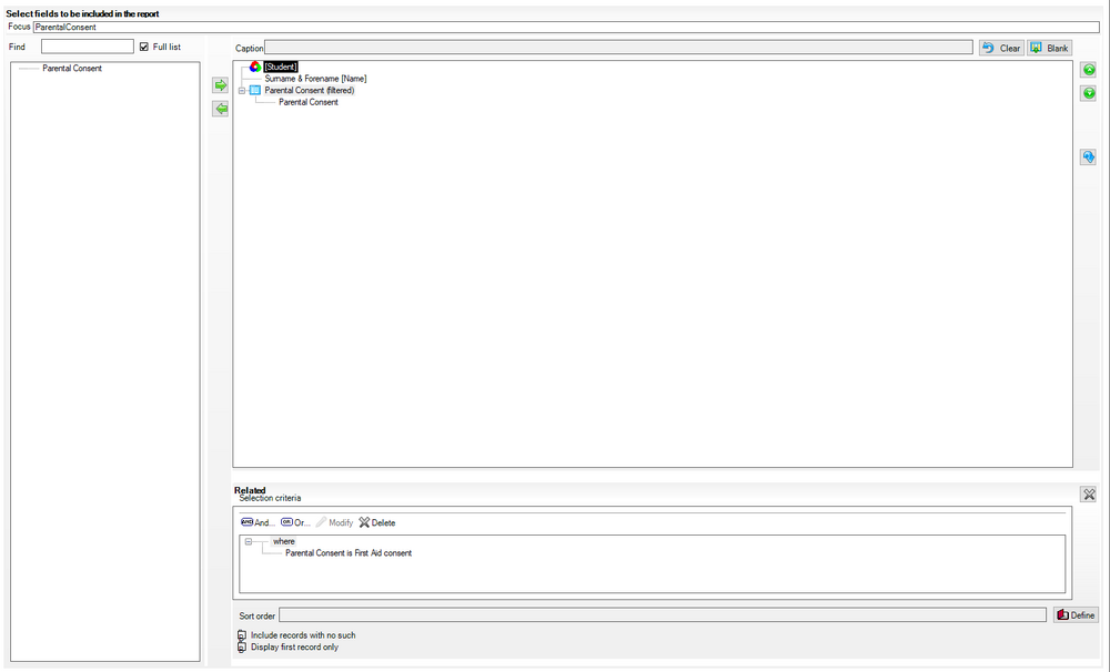

  12. See attached screenshot and report definition that you can import into SIMS > Reports > Import. It's called "Parental Consent PAH" and is filtered on First Aid consent, to give you an example. Peter ConsentReport.zip
  13. He's only seeing (count) on the right hand side because he's not selected sub-fields on the left hand side, within that blue sub-data-set. I have permissions to all of SIMS and see the same as your screenshot when not inside the blue dataset, but if you click your mouse onto the Parental Consent dataset on the right, your field set on the left will show the same as OPs.
  14. Hi There is only one data field under Parental Consents, which (unhelpfully in this case) is itself called Parental Consent - so on the left of your screenshot you need to add the field over to the right as you would any other field. Peter
  15. Once you've added "Parental Consent" to the right hand side, click on it and the field list on the left will change from the student details(etc etc etc) to the fields relating to Parental Consent - you then need to add at least one field from here. I can't find Consents in the list to give you the exact screenshot, but it's the same concept:
