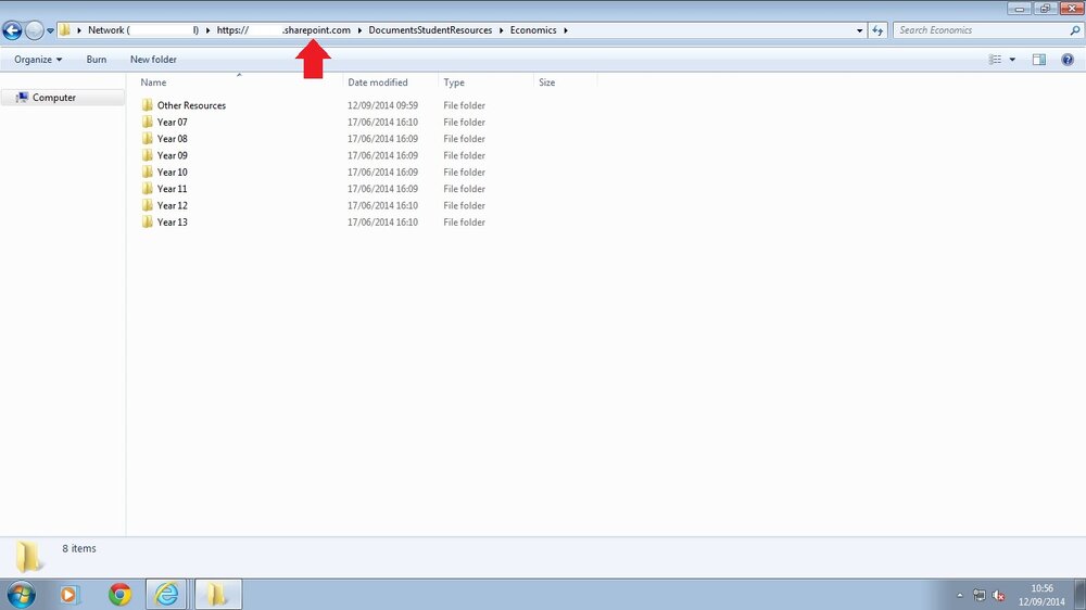

Ok, I've seen a few blogs explaining how to disable the 'Open with Browser' button but they appear to be hacks rather than proper solutions... I guess we'll have to see how things go. Thanks for the reply Ben
Hi, We're just starting with SharePoint (Office 365) and have our site set-up with various departments and this all works great through a browser. We also like the idea of being able to open a folder via the 'Open with Browser' option and again this works fine but we have an issue with staff/students being able to navigate back up the tree and doing things they shouldn't in the root of our site. We've set permissions on the folder structure we set-up and that prevents users from doing things they're not supposed to do but we don't see how to stop users navigating back up the tree into the root. I've attached a screenshot showing where users can click and enter areas their not supposed to. Anyone know how to stop this? Thanks Ben
