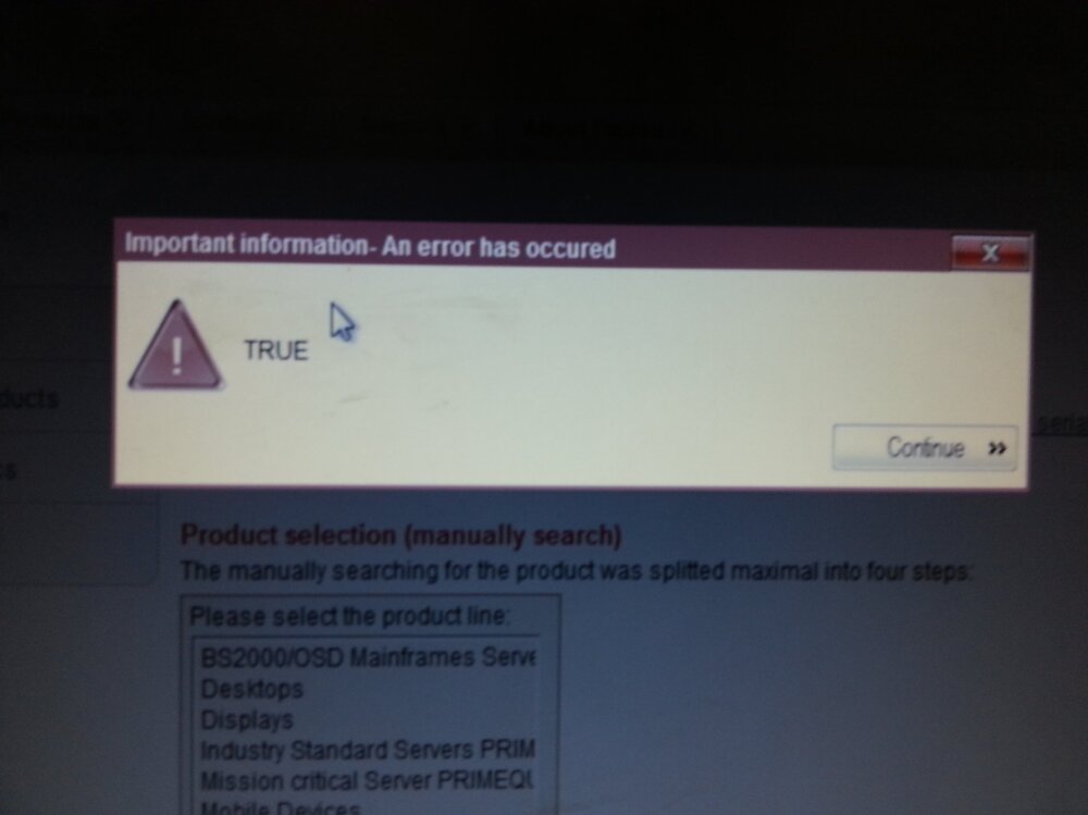

This helpful error message gave me a laugh - it's true there was an error! in this case it was an incorrectly entered serial number, but Fujitsu weren't going to tell me that!
