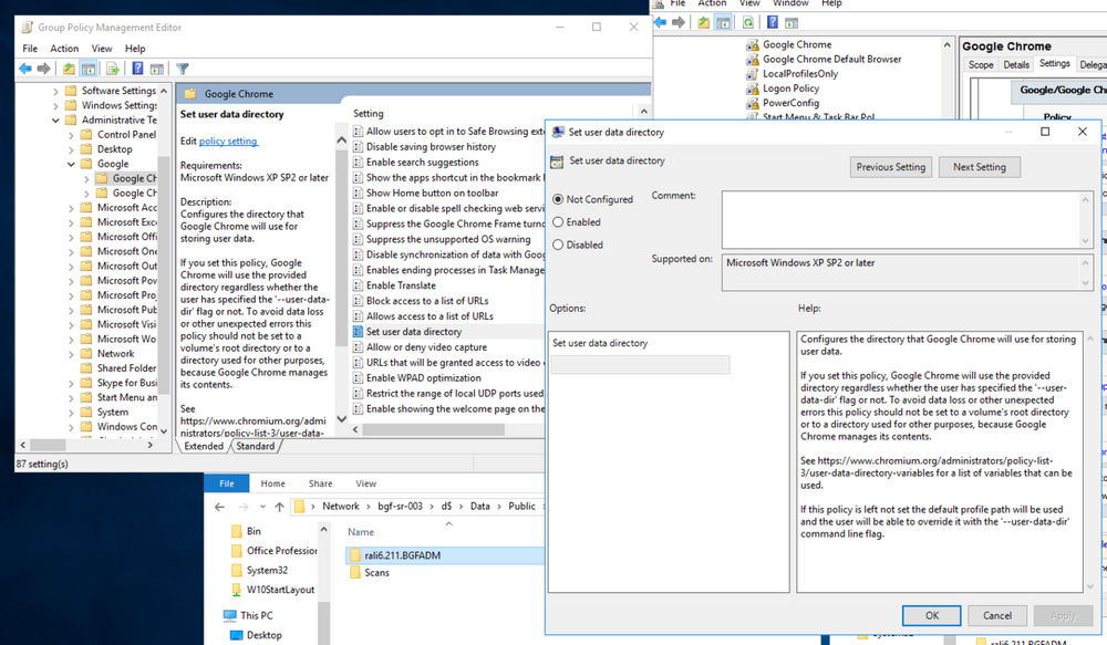

  20. The root problem of this is that Chrome data file is being stored on a share so only 1 instance can run. If it is stored locally it means multiple instances can be run. It could be caused by this group policy setting on the attachment. This can help https://support.google.com/chrome/a/answer/7349337?hl=en When you say support who is that please?
