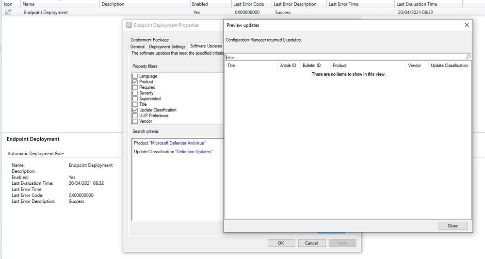

  16. Thanks for replying. Yes, you are correct there are no items shown in the preview. Do I need to alter the settings to 'create a new software update group?' or will this create a new group every time it runs? Perhaps I selected existing and this is why it's not working (although I would have thought it would have asked me for the name of the SUG?)
  17. Thanks for the reply, very much appreciated. We don't have anything created in Software Update Group. These are the instructions we followed to create the automatic deployment rule. Perhaps I did something wrong here, it's been a minefield! https://docs.microsoft.com/en-us/mem/configmgr/protect/deploy-use/endpoint-definitions-configmgr How can I now create a SUG and link it to this Automatic Deployment rule? Many thanks again!
  18. Hello all, Hoping someone can help. My colleague and I have installed SCCM from scratch. The system seems to generally be working ok. We are following MS guidance to configure Endpoint Protection as the first thing we want to do is get Defender managed on all the existing clients. We have created an automatic deployment rule to target a custom device collection called 'Win 10 Clients' We have download definition updates but how do we push these updates to our collection? Do we need to create a software update group and if so, is this a one time thing? Definitions are downloaded every day (as we have specified this) but of co-course, we don't want to be doing a manual process every day of the week. I have attached some screenshots which might help explain. Any help would very much appreciated as we are SCCM novices! Many Thanks
