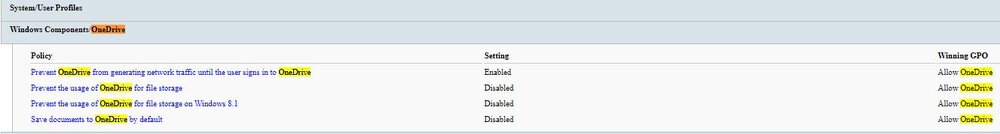

  10. Hello all, We are very late to the party with OneDrive but want to allow students and staff to start using this soon. When I inherited this role, I noticed the native OneDrive wasn't enabled. I found a GP called disable one drive with various settings configured including 'prevent the usage of OneDrive for file storage' which was set to enabled. I removed this policy so it was not applied anywhere, waited ages, still no OneDrive. I then deleted the policy, no difference. I then made a new one called 'enable one drive' and reversed the settings and applied it to a test OU. If I run a Group policy modelling wizard for test staff on a test pc, I can see it should be applied: Annoyingly, as it's a computer setting, gpresult doesn't show the computer policies being applied but based on the modeling, I'm pretty sure it is being applied but for some reason, OneDrive is not pinned. Also, If I click on the flag and type 'OneDrive, I get the following: If I log in as domain admin on the test pc, it's pinned and if I click on the flag and type OneDrive it brings up the usual 'sign in to OneDrive' box which is what I want for staff and students. I have searched the modelling results for 'OneDrive' but can't see anything else other than the settings above. I can't see any reg settings to block the icon either. I have tried enforcing the gp and even blocking inheritance so it just be applying that policy but it still doesn't work for a test staff or student account. Any help or guidance would be much appreciated.
