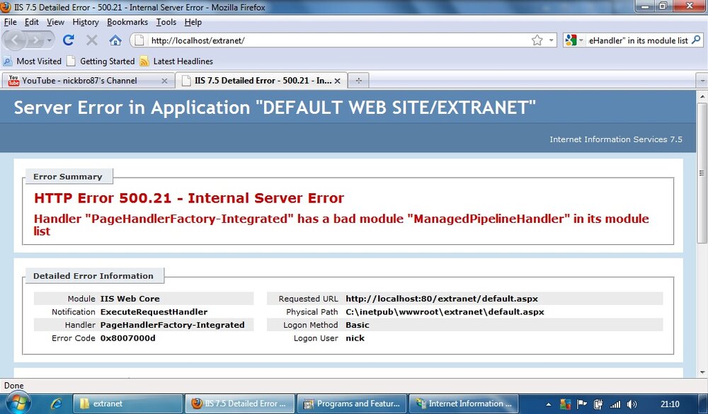

Hi i have followed the installation video for hap v4 and i am getting this error. anyone any ideas? nick
