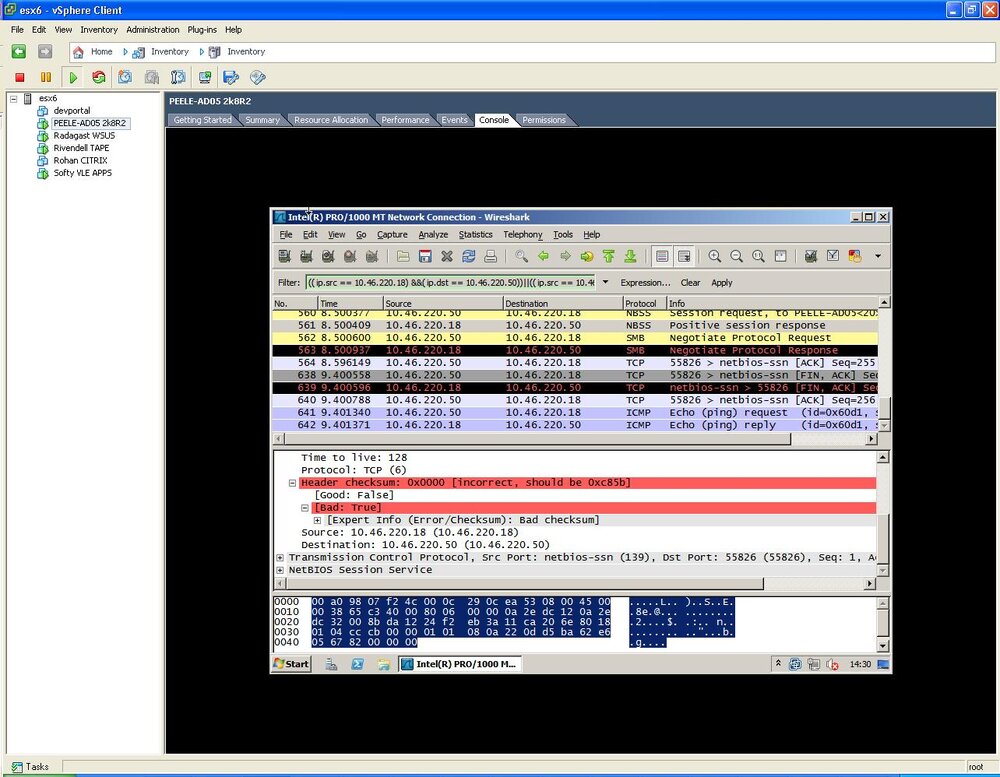

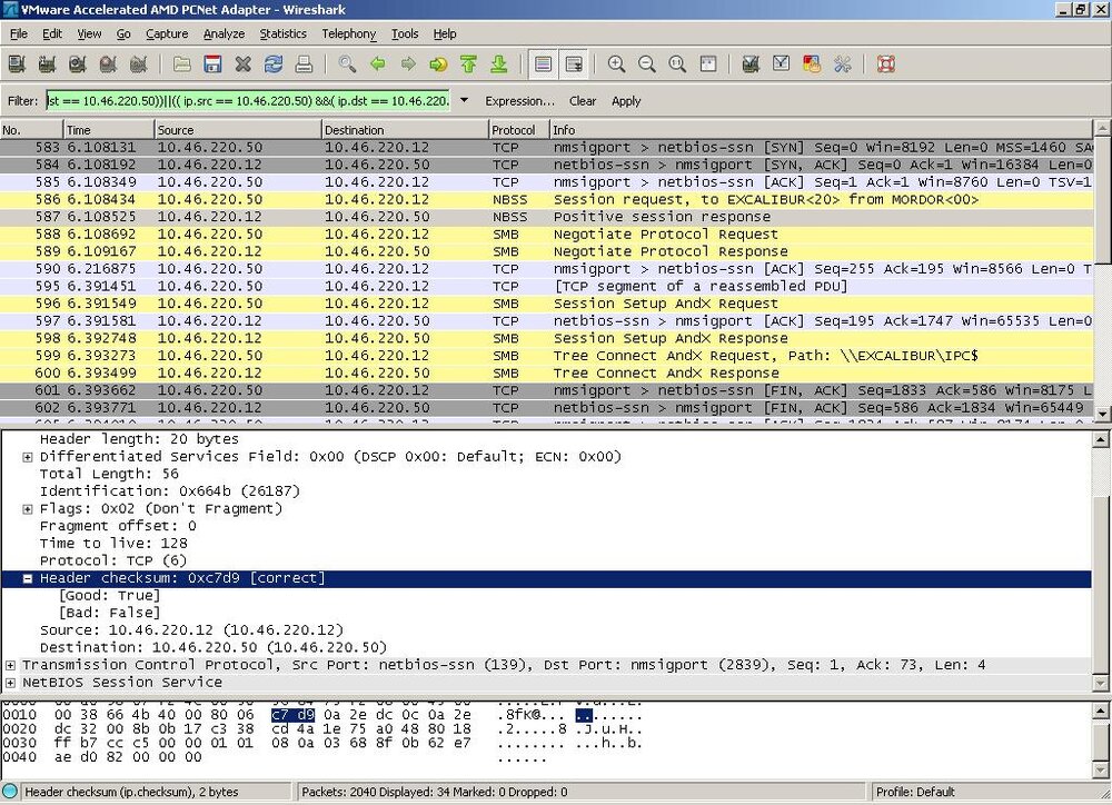

Have used wireshark on both dc's (the 2003 and a 2008) the problem appears to be a header checksum. The san makes a session request to the 2008, the 2008 replies with the wrong checksum. Wireshark shows an error, which says wrong checksum. This is obvioustly what is wrong. The 2k3 sends the correct checksum which is why it connects. see pics anyone any ideas why 2008 is sending wrong checksum?? thanks nick
