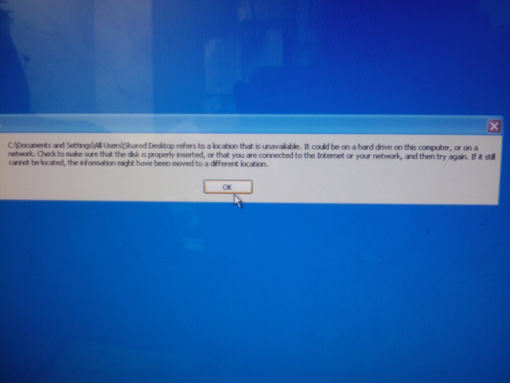

  15. Hi Guys, We are in the progress of testing a new vanilla network going away from CC3. We are doing this on XP for the moment and we are at the last stages of testing before we go LIVE during the summer. We have done this on an RM ONE machine and have managed to completely create a student profile just on XP, it's extremely fast, faster than CC3 (cough). However when you log in and get to the desktop a very long error message appears. I have attached the photo of the message. Please let me know what you might think the error message meens and how we should remove this. It appears all the time when you log in. Thanks
