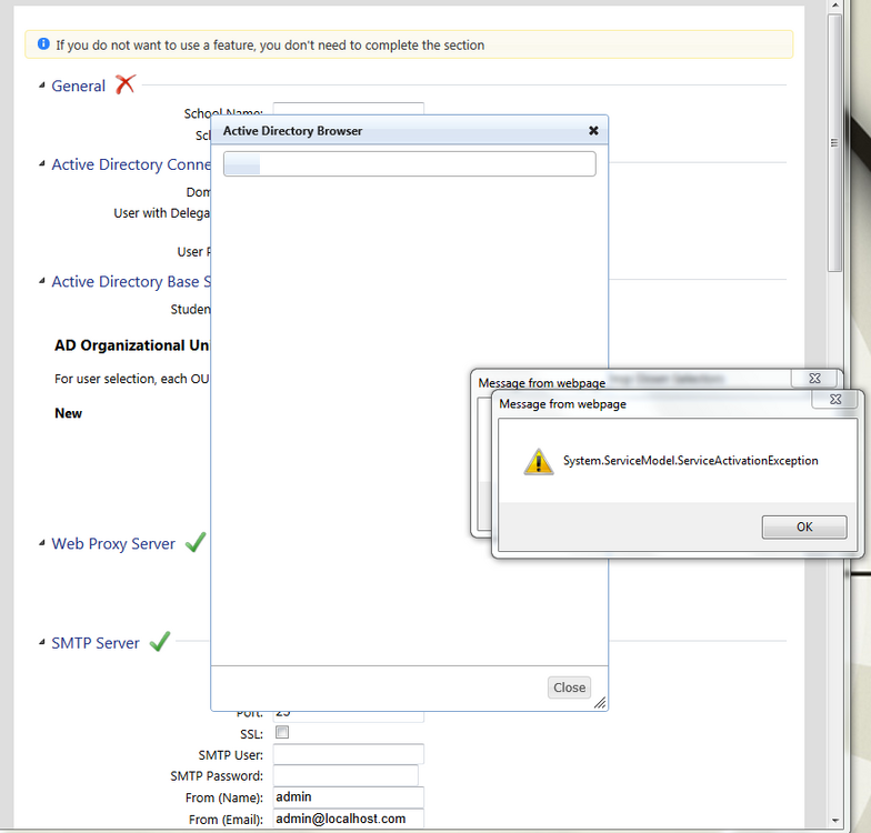

jamesfed Posted September 20, 2011 Report Posted September 20, 2011 Hi Nick, Sorry same message as all others - I've done a clean install (at least I belive I have ) but get the attached screen shot message every time. Event viewer (Server 2008 R2/IIS 7) Comes up with the following- WebHost failed to process a request. Sender Information: System.ServiceModel.ServiceHostingEnvironment+HostingManager/63835064 Exception: System.ServiceModel.ServiceActivationException: The service '/v7/api/setup' cannot be activated due to an exception during compilation. The exception message is: This collection already contains an address with scheme http. There can be at most one address per scheme in this collection. If your service is being hosted in IIS you can fix the problem by setting 'system.serviceModel/serviceHostingEnvironment/multipleSiteBindingsEnabled' to true or specifying 'system.serviceModel/serviceHostingEnvironment/baseAddressPrefixFilters'. Parameter name: item. ---> System.ArgumentException: This collection already contains an address with scheme http. There can be at most one address per scheme in this collection. If your service is being hosted in IIS you can fix the problem by setting 'system.serviceModel/serviceHostingEnvironment/multipleSiteBindingsEnabled' to true or specifying 'system.serviceModel/serviceHostingEnvironment/baseAddressPrefixFilters'. Parameter name: item at System.ServiceModel.UriSchemeKeyedCollection.InsertItem(Int32 index, Uri item) at System.Collections.Generic.SynchronizedCollection`1.Add(T item) at System.ServiceModel.UriSchemeKeyedCollection..ctor(Uri[] addresses) at System.ServiceModel.ServiceHost..ctor(Type serviceType, Uri[] baseAddresses) at System.ServiceModel.Activation.WebServiceHostFactory.CreateServiceHost(Type serviceType, Uri[] baseAddresses) at System.ServiceModel.Activation.ServiceHostFactory.CreateServiceHost(String constructorString, Uri[] baseAddresses) at System.ServiceModel.ServiceHostingEnvironment.HostingManager.CreateService(String normalizedVirtualPath) at System.ServiceModel.ServiceHostingEnvironment.HostingManager.ActivateService(String normalizedVirtualPath) at System.ServiceModel.ServiceHostingEnvironment.HostingManager.EnsureServiceAvailable(String normalizedVirtualPath) --- End of inner exception stack trace --- at System.ServiceModel.ServiceHostingEnvironment.HostingManager.EnsureServiceAvailable(String normalizedVirtualPath) at System.ServiceModel.ServiceHostingEnvironment.EnsureServiceAvailableFast(String relativeVirtualPath) Process Name: w3wp Process ID: 5080 I could well be wrong in my understanding but in that error message it mentions /v7/api - where v7 is my HAP folder however I dont have a api folder anywhere to be seen (although I think I can see one in your demo setup videos). Either way v6 is running great and thanks for a wonderful bit of software!

jamesfed Posted September 20, 2011 Report Posted September 20, 2011 Can you navigate to /v7/api/setup in the browser and tell me if it loads up It loads with attached message on screen
nickbro Posted September 20, 2011 Report Posted September 20, 2011 It loads with attached message on screen I have no idea on that error, have you tried googling/bingging it?

jamesfed Posted September 20, 2011 Report Posted September 20, 2011 I have no idea on that error, have you tried googling/bingging it? Nothing helpful on first look but something just started a thought process - looked like there was a HTTP binding to the site which was throwing up all the errors. All working now though. Thanks again Nick!
nickbro Posted September 20, 2011 Report Posted September 20, 2011 Nothing helpful on first look but something just started a thought process - looked like there was a HTTP binding to the site which was throwing up all the errors. All working now though. Thanks again Nick! Good to hear. Thankfully, you wont have to go through the full setup next time
Simmer Posted September 20, 2011 Report Posted September 20, 2011 Redone the install 3 times now and i can get the setup page to appear but when i click on the test button i get a popup saying "System.ServiceModel.ServiceActivationException"
TronXP Posted September 20, 2011 Report Posted September 20, 2011 As jamesfed said above, you need to goto your site bindings (IIS Manager > Sites > "Site Name" > In the actions pane look for "bindings") ensure there is only one binding for http. I also had this problem.
nickbro Posted September 20, 2011 Report Posted September 20, 2011 Ask James how he fixed it. It's prob a binding issue in IIS Nothing helpful on first look but something just started a thought process - looked like there was a HTTP binding to the site which was throwing up all the errors.
jamesfed Posted September 20, 2011 Report Posted September 20, 2011 Ask James how he fixed it. It's prob a binding issue in IIS Yep I just had HTTP enabled on the IIS site I had setup for HAP - just click on site (left hand side of the IIS window) then on the right click bindings and remove any mention of HTTP and only leave HTTPS.
