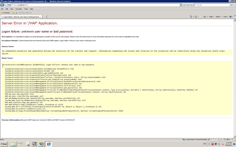

After a bit of additional tweaking to the web.config file (removing the lines about endpoints and setting the svg mime type), I got everything running and could log in. however now when I try, I get a logon error saying unknown user or password (screenshot below). I've tried restarting IIS a few times, but the error remains, also tried domain admin, staff and pupil logons, all of which fail.
Any ideas?

The username/password entered into setup.aspx isn't correct. Make sure it's the administrator's username/password
Perfectly possible I typed it incorrectly - how do I now change it though? When I browse to ~/hap/setup.aspx, I just get the logon screen...

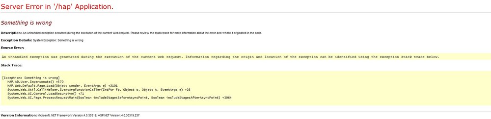

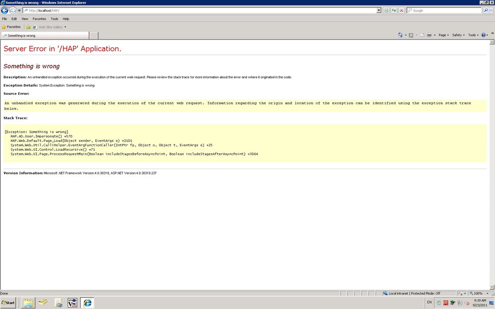

Thanks Nick. I've changed the password and re-instated the (as per the instructions on the setup page); I can still log in but everyone else gets the below message.
As it suggests something is wrong when it's trying to impersonate the current user, which is very odd. What User are you running the HAP+ application pool as?
Do you mean the process model identity in IIS? If so, that is set "application pool identity"; if you mean the user specified in setup.aspx, that is administrator.
You answered both questions there, it's very strange that it isn't able to impersonate the current user, which is where the error is coming from. Is there anything in the event logs on the server which may give a clue

Hopefully they mean more to you than they do to me!
Is interactive logons disabled on your server, as HAP+ uses interactive logons to impersonate the user
No, "allow logon locally" is defined just to administrative groups, and "impersonate a client after logon" is not configured. I'm somewhat cautious about changing settings at such a high level - what else am I potentially exposing myself to by changing this? Is there anything I need to be aware of once I've changed it?
