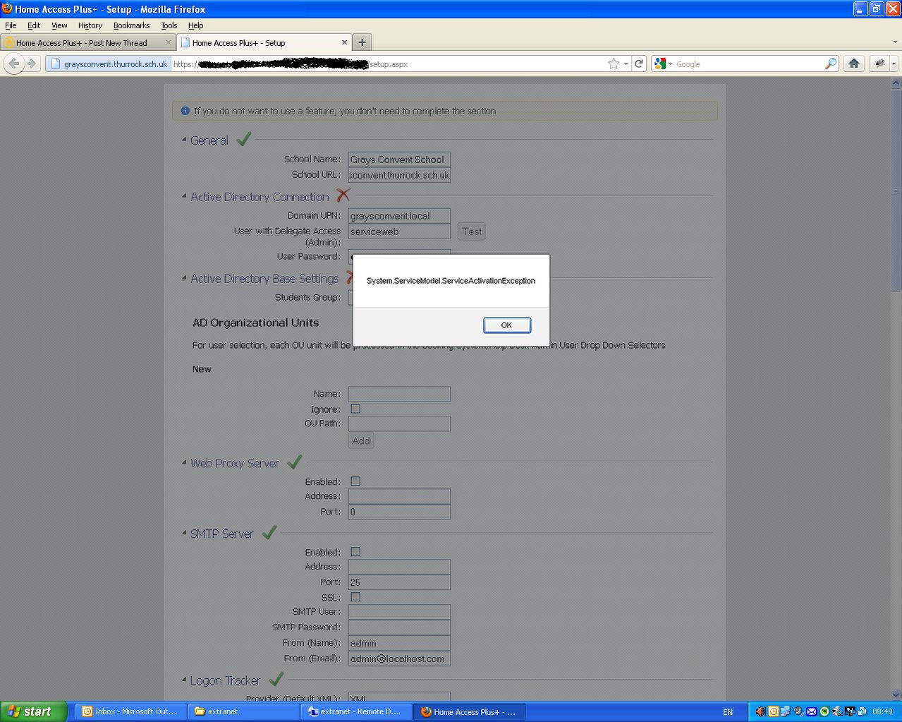

2097 Posted September 19, 2011 Report Posted September 19, 2011 (edited) Hi Nick , Love the prorgram btw , keep up the good work . Decided to go for an upgrade to the latest v7 All i did was remove the contents of our HAP folder and replaced with the latest v7 files and ran the v7 setup.aspx ( i assume its all setup ok as previous versions work fine) I get the following error when entering in and clicking the test button on the domain UPN / username and password Any information on what i might have done wrong ? Edited September 19, 2011 by 2097

nickbro Posted September 19, 2011 Report Posted September 19, 2011 Hi Nick , Love the prorgram btw , keep up the good work . Decided to go for an upgrade to the latest v7 All i did was remove the contents of our HAP folder and replaced with the latest v7 files and ran the v7 setup.aspx ( i assume its all setup ok as previous versions work fine) I get the following error when entering in and clicking the test button on the domain UPN / username and password [ATTACH=CONFIG]11313[/ATTACH] Any information on what i might have done wrong ? It's preferable to use the Administrator's Account for Directory Access, it's down to permissions on AD. The Admin Password is Encrypted in the web.config

nickbro Posted September 19, 2011 Report Posted September 19, 2011 Hi Nick , Love the prorgram btw , keep up the good work . Decided to go for an upgrade to the latest v7 All i did was remove the contents of our HAP folder and replaced with the latest v7 files and ran the v7 setup.aspx ( i assume its all setup ok as previous versions work fine) I get the following error when entering in and clicking the test button on the domain UPN / username and password [ATTACH=CONFIG]11313[/ATTACH] Any information on what i might have done wrong ? Are you an RM School? RM's naming scheme is usually school.internal

gumbygaz Posted September 19, 2011 Report Posted September 19, 2011 (edited) I'm still getting the initial problem.... Tried starting from Scratch but with no success.. Not sure what I'm doing wrong. I'm an RM Site & using IIS6. Anything I could try? Thanks! Seen this in the Application Logs on the Server... Anything to do with my installation issue? Event Type: Error Event Source: System.ServiceModel 4.0.0.0 Event Category: WebHost Event ID: 3 Date: 19/09/2011 Time: 10:45:30 User: NT AUTHORITY\NETWORK SERVICE Computer: CHA-SR-001 Description: WebHost failed to process a request. Sender Information: System.ServiceModel.ServiceHostingEnvironment+HostingManager/34717384 Exception: System.ServiceModel.ServiceActivationException: The service '/HAP/api/setup' cannot be activated due to an exception during compilation. The exception message is: Could not find a base address that matches scheme http for the endpoint with binding WebHttpBinding. Registered base address schemes are [https].. ---> System.InvalidOperationException: Could not find a base address that matches scheme http for the endpoint with binding WebHttpBinding. Registered base address schemes are [https]. at System.ServiceModel.ServiceHostBase.MakeAbsoluteUri(Uri relativeOrAbsoluteUri, Binding binding, UriSchemeKeyedCollection baseAddresses) at System.ServiceModel.Description.ConfigLoader.ConfigureEndpointAddress(ServiceEndpointElement serviceEndpointElement, ServiceHostBase host, ServiceEndpoint endpoint) at System.ServiceModel.Description.ConfigLoader.ConfigureEndpoint(StandardEndpointElement standardEndpointElement, ServiceEndpointElement serviceEndpointElement, ContextInformation context, ServiceHostBase host, ServiceDescription description, ServiceEndpoint& endpoint, Boolean omitSettingEndpointAddress) at System.ServiceModel.Description.ConfigLoader.LookupEndpoint(ServiceEndpointElement serviceEndpointElement, ContextInformation context, ServiceHostBase host, ServiceDescription description, Boolean omitSettingEndpointAddress) at System.ServiceModel.Web.WebServiceHost.AddAutomaticWebHttpBindingEndpoints(ServiceHost host, IDictionary`2 implementedContracts, String multipleContractsErrorMessage, String standardEndpointKind) at System.ServiceModel.Web.WebServiceHost.OnOpening() at System.ServiceModel.Channels.CommunicationObject.Open(TimeSpan timeout) at System.ServiceModel.Channels.CommunicationObject.Open() at System.ServiceModel.ServiceHostingEnvironment.HostingManager.ActivateService(String normalizedVirtualPath) at System.ServiceModel.ServiceHostingEnvironment.HostingManager.EnsureServiceAvailable(String normalizedVirtualPath) --- End of inner exception stack trace --- at System.ServiceModel.ServiceHostingEnvironment.HostingManager.EnsureServiceAvailable(String normalizedVirtualPath) at System.ServiceModel.ServiceHostingEnvironment.EnsureServiceAvailableFast(String relativeVirtualPath) Process Name: w3wp Process ID: 1968 Edited September 19, 2011 by gumbygaz Additional information added

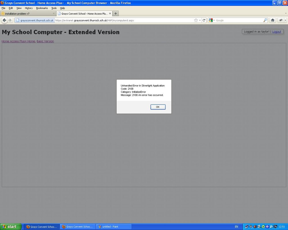

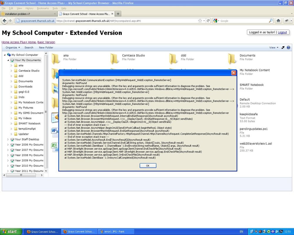

2097 Posted September 19, 2011 Author Report Posted September 19, 2011 (edited) Ok heres a summary as to whats not working nick to help you out ( im running IIS6). Using the Drag and Drop Feature it states that the file extension is not allowed for any file i copy to it ( HTML upload works ) Clicking the browse button (...) under the drag and drop text brings up a error ( fileDialog_InvalidFilter) When i first login to the extended version i get the following Using the extended version seems to cause some errors , When uploading for example it freezes then a massive error comes up which i have attached Edited September 19, 2011 by 2097
nickbro Posted September 19, 2011 Report Posted September 19, 2011 Thanks, will look into these bugs. The beta test wasn't very successful.

nickbro Posted September 19, 2011 Report Posted September 19, 2011 v7.1.1909.1640 has just been checked into codeplex source control which fixes the above issues, hopefully. Will release the update later today
nickbro Posted September 19, 2011 Report Posted September 19, 2011 You can download the latest release from Home Access Plus+ - Download: v7.1 which should fix the issues. Once again sorry about this, I didn't manage to check it enough before release
KayDubYa Posted September 19, 2011 Report Posted September 19, 2011 Great job Nick. I seem to have one problem. I cannot see any drives in the extended version, basic works fine. No other problems.
KayDubYa Posted September 19, 2011 Report Posted September 19, 2011 Try clearing your browser cache No luck. Tried multiple machines. The page loads but no drive letters are displayed. Same happens in Firefox and IE.
KayDubYa Posted September 20, 2011 Report Posted September 20, 2011 Are you using HTTPS? Doh!...I am so sorry. No I was not using HTTPS, everything is working perfect now. Thank you so much Nick and keep up the good work.
