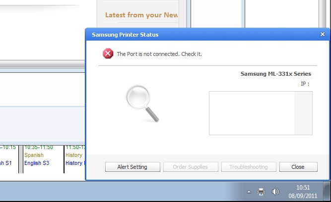

We have 2 x Samsung ML-3310 printers on the network.
Both are added to the print server and shared. When anyone prints to either of them they both get the error popup from the status monitor.
"The Port is not connected. Check it" (See attached screenshot)
Has anyone come across this and solved it maybe :)
The printer still prints the jobs after a small delay?

No. We use Symantec Endpoint Protection. We'e just replaced all our printers with Samsungs and this is slightly annoying!!
It does this also when I try to print from our print server, so I don't think its the client. Our print server is a 2008 virtual server. Yes very annoying!!
Edited by burgemaster
The company that is supplying our printers is speaking to Samsung about it.. Hopefully they might provide a solution or a driver without the annoying popup.
we've got this too, and it is very annoying, not to mention off puting for the students. samsung are useless and can only offer to replace printers. The problem also seems to be intermittent, and seems related to the length of time taken to print. for example, a printer connected via usb to a machine and shared, prints very quickly with no error, a printer installed via ethernet on a server based print queue seems to take longer and gives the error. we are using eset, and the error seems unrelated.
Removed Sophos from the client and the print server. This still happens, so thats sophos/antivirus ruled out.
We get it 100% of the time.
If we could just get rid of the pop up completely I would be happy.

I get a similar problem on some of my HP printers, I can cure this issue by disabling the "monitoring" check box in the driver and also for one of my sharp printers the two way communications on the ip ports config. aka "bidirectional support" Edited by chazzy2501
