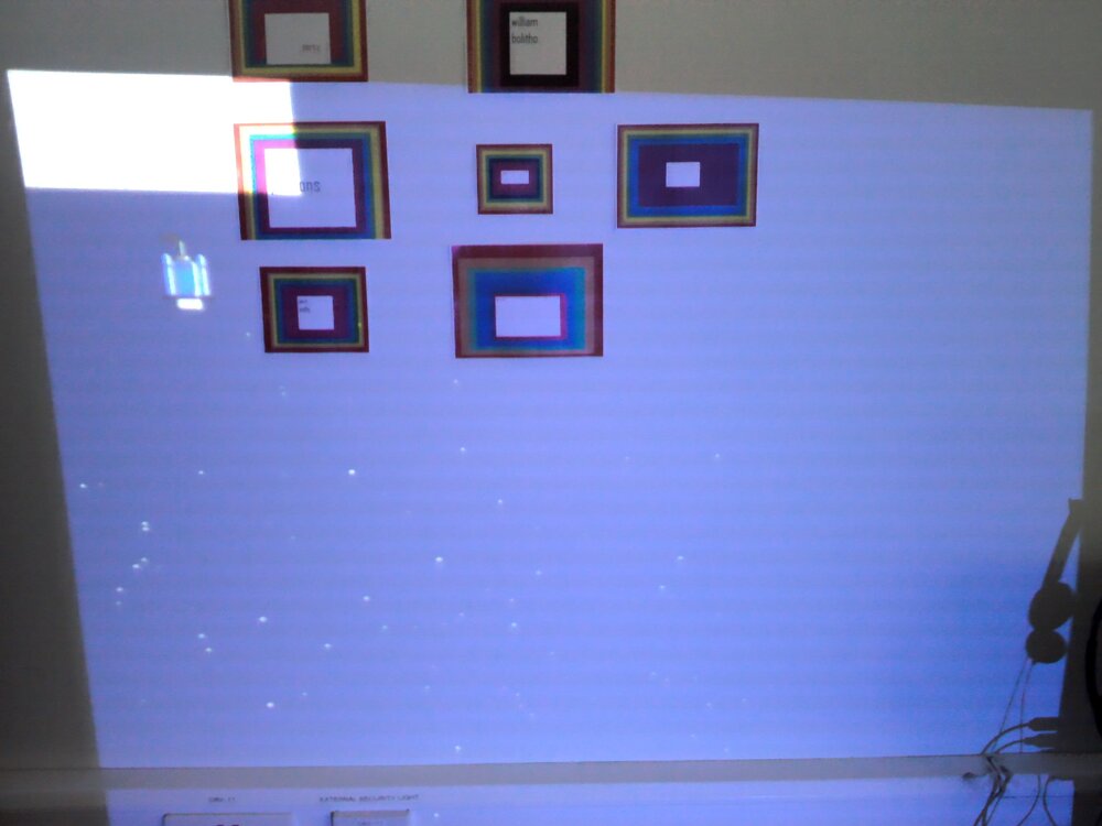

Attached an image that shows it fairly well, also some of them flicker a bit
In therory your right but in practice you would have to have a pixel in each screen in the same place to get a white light, so if your right i would go buy a lottery ticket as it would be a one in a milliion chance, but seriously i am interested to see what it is, i have repaired hundreds of these and NEVER seen a white pixel LCD problem i think it more likley to be a contoller issue, but get me a photo and or if you lke i will ring you to get to the bottom of it PM me and i can ring you.

Yes they do get worse we call it creaping coruption, as it seems to grow once started (oh dear another DLP), if its not uner warranty then it will be a replacement, sorry.

I have seen this problem in a lot of infocus and sharp projectors. It is a defective DLP chip, however I have never sent one in for repair so I don't know how expensive it would be. Also I've never been able to order a replacement DLP chip from any vendor either.

Resurrecting an old thread, but this has recently happened to one of our Toshibas. The general consensus is that you need to replace the DMD chip: DMD Chip
Considering the cost is a third that of a new projector, I don't think we'll bother taking the chance.
I've had an Epson do this... and an NEC - both LCD, turned out to be a driver chip breaking down (supplied by NEC) was more expensive to have repaired than to get a new projector.
