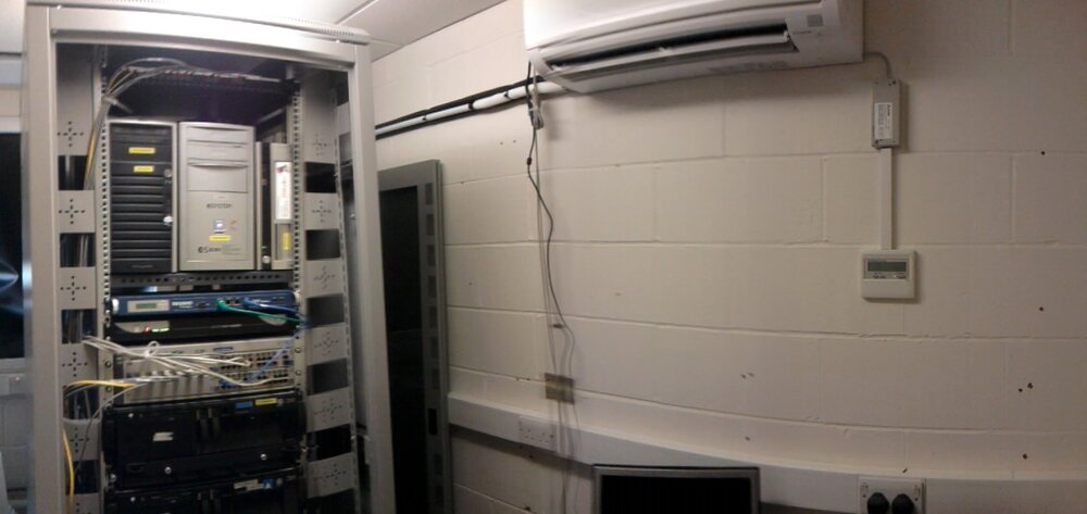

After 5 long years I finally have some air con in our dedicated server room. It's a small room.
So I am wondering what the best temp would be to set it to - what do you have yours set to ?
I was used to air con in vast data centers before so have no idea what to set it to for this small setup.......

It was set to 16 [ lowest it would go ] - blooming chilly in there !! Have now set it to 18. WIll RTFM later to work out how to turn it off when it gets to the relevant temp.....

It took me 5 years !! And now all the kit is out of our office and in a dedicated room - my working environment has improved about 1000%
