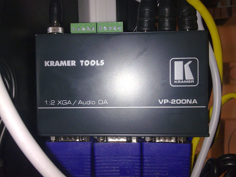

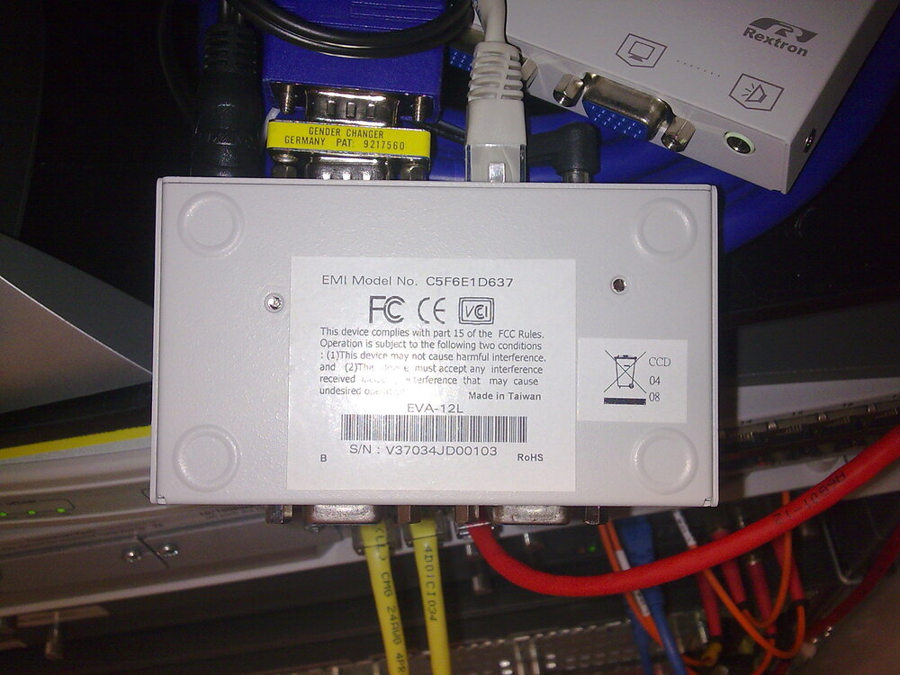

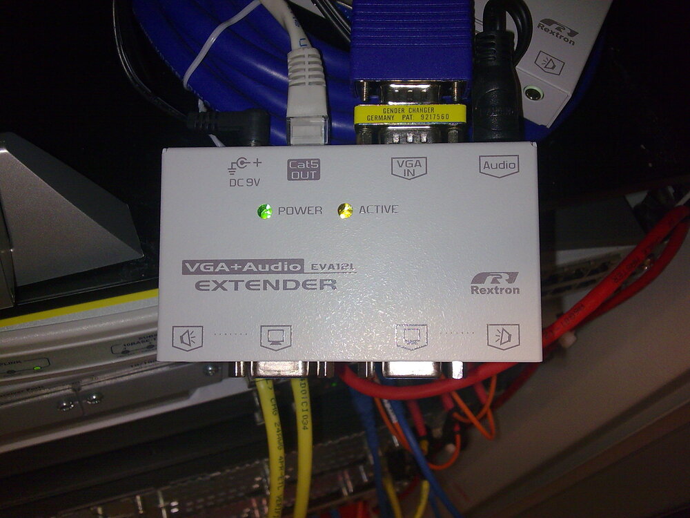

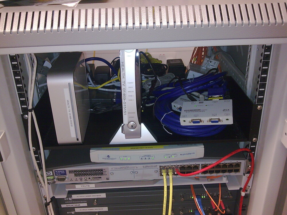

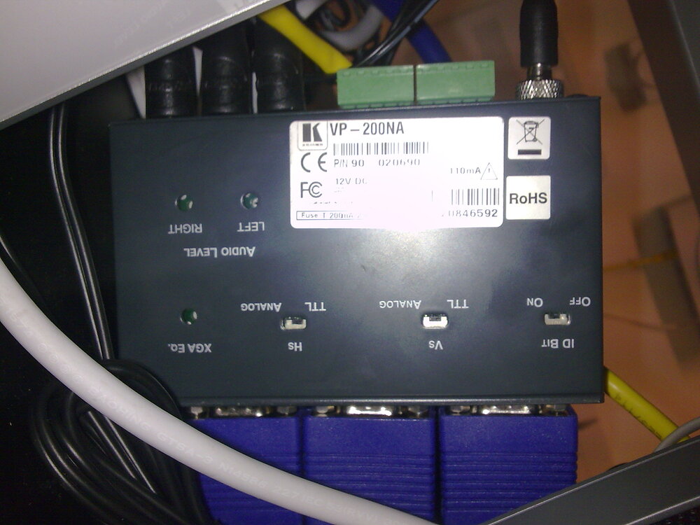

Attached are some images of one of our units we use, it connects to the MacMini and shows something on the TV screens. I will get to the other site and look at the 1U unit we have there as well.
[ATTACH=CONFIG]7794[/ATTACH][ATTACH=CONFIG]7795[/ATTACH][ATTACH=CONFIG]7796[/ATTACH][ATTACH=CONFIG]7797[/ATTACH][ATTACH=CONFIG]7798[/ATTACH]
