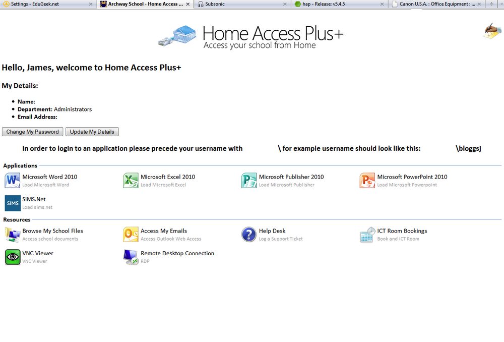

First day back, just got around to updating, thank you very much for the last update nickbro im very happy with how ours looks now :)

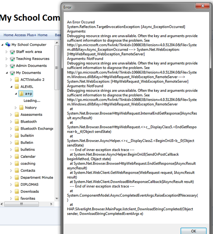

Found a problem mentioned by a member of staff this morning, see the image below, could it be to do with the "+" symbol in the folder name?
yes this is true, + and & symbols do not work in home access plus for file or folders.
Ah ok, mildly annoying but not a huge issue i guess and easily resolved :)
Actually, no I didn't: Home Access Plus+
Problem with + in folder/file name
Run:
%windir%\system32\inetsrv\appcmd set config "Default Web Site" -section:system.webServer/security/requestFiltering -allowDoubleEscaping:true
Note that "Default Web Site" should be replaced with the IIS website name
