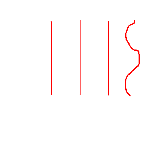

Dom_ Posted March 2, 2010 Posted March 2, 2010 Noticed at 2 of the sites I visit there is a problem with a smartboard at each - if i draw a straight line down the right hand side of the board it ends up like the attached pic... This happens immediately after a calibration 9/20 point. Any idea's?untitled.bmp
john Posted March 2, 2010 Posted March 2, 2010 Any metal work or items such as unshielded speakers next to or near the board or behind it? 1
Dom_ Posted March 2, 2010 Author Posted March 2, 2010 No, and the screw heads are covered with velcro so i don't think its the grounding issue
Dom_ Posted March 2, 2010 Author Posted March 2, 2010 Also - this boards been in for 4-5 years and has only just developed this problem.
jamiesev Posted March 2, 2010 Posted March 2, 2010 Any metal work or items such as unshielded speakers next to or near the board or behind it? You may also want to check what you have screwed the board onto. We had a similar problem with an old porta cabin as there were still rods behiind the wall that one of the screws was touching. Rapping the screw ends with electrical tape solved the problem. You may also want to run the usb cable through a powered usb hub as this solved the issue in another school I worked in. 1
Dom_ Posted March 2, 2010 Author Posted March 2, 2010 I'll try the powered hub and investigate further when i'm in next week, they're trying to use it at the mo so i can't get to it
john Posted March 2, 2010 Posted March 2, 2010 Check to see if the wall / board has warped / moved, if its well fixed to the wall then if the walls moved (If its timber studwork for example) it may have moved and skewed the board slightly.
Educare_AV Posted March 2, 2010 Posted March 2, 2010 Try totally removing the bottom screws behind the pen tray. Check the board for any small pin prick holes. If this has only just started, I would suspect the board too, has warped. Maybe happened due to the increased temperature in the rooms with the heating being used over the winter months.
