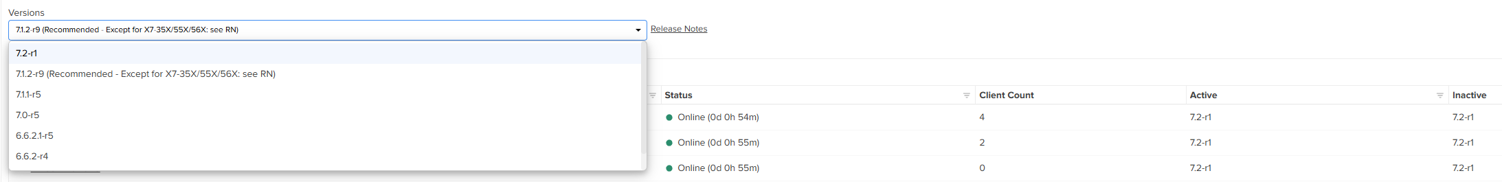

41 minutes ago, DavR said:
We're using 7.1.1r5 on our X7-35X APs. On the cloud controller, this is listed as the recommended firmware, even though there are newer ones available.
On the cloud controller, you should be able to use the Software Update tool and just roll back. Unless you're on the on prem already and that's not an option?
Wonder if this is something that can be set manually - ours shows recommended 7.12-r9 except X735/55 in which case 7.2-r1
*** Edit: yup - when you upload a firmware, you can tick a box which says it's recommended :)
Edited by synaesthesia
Looks like the recommended tag is dependent on your configuration. I just offered 7.2r1 to one of my X7-35X, and it said it would break my access control policies if I did.
