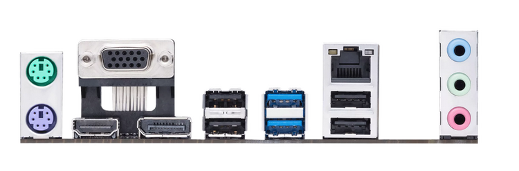

Also I checked the BIOS as pic attached and it was already enabled.
An ASUS H510M-A Motherboard with a 10th Gen processor is supposed to support 3 monitors (Copilot told me)

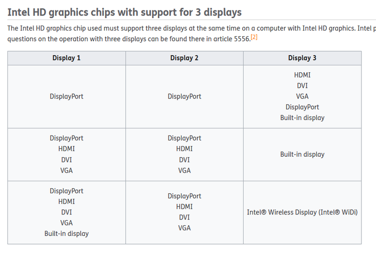

Unless I read this wrong, for three displays, Displayport & HDMI & VGA isn't an option:
Which is what I assume you have?
Just read that and who would have thought that you couldn't have that Combo as its the 3 ports on the motherboard 🤷🏻‍♂️ I've ordered a HDMI to DP Adaptor so hopefully I can get a combination to work as below
Going by this you are in the first row, you need 2 monitors to be on DP and 1 to be anything else
Not the 2nd row as you dont have built in and not 3rd as no wireless.

2 minutes ago, JazzFlute said:
Downloaded the latest driver version for Intel UHD Graphics 630 Driver Date: 05/11/2025 and still the same issues.  Can only get a combination of 2 external monitors displaying.  i think the UHD Graphics 630 doesn't support 3 external monitors but only if you have a main display (laptop screen) and then 2 outputs on your laptop which is rare.  I am waiting on a new PC with UHD 770 Graphics like yours and Ill update then to see if it works.  I was just trying to get 3 monitors set up on the UHD 630 to test beforehand but don't think its possible.
Yes i can only do the first row so tried the below and still doesn't work.  I imagine adaptors etc. are not native and wont work but what motherboard with the Intel UHD 630 Graphics has 2 DP outputs? probably none so a bit pointless truing top setup 3 extended monitors.

HDMI to DP, is this an adapter? if so is the adapter the PC side not the Monitor side? if its a cable have you checked if its bi-directional?
Its a cable and just checked its only Uni-Directional as picture..... Doh my bad.
