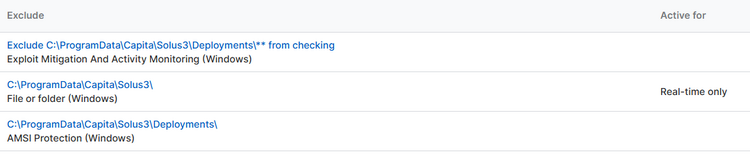

1 minute ago, 5nowman said:
Did you do the following in sophos too - server and workstation?:
AMSI Protection:
C:\ProgramData\Capita\Solus3\Deployments\
C:\ProgramData\Capita\Solus3 - Real-time only
Exploit Mitigation And Activity Monitoring:
C:\ProgramData\Capita\Solus3\Deployments\**

This has been posted before but worked for us...
AMSI Protection:
Edited by TooOld4This
Where is SIMSApplicationSetup.exe running from?
It sounds like the paths that @TooOld4This has given you are for Solus, but if you are deploying SIMS using another method, you'd need to apply similar exceptions to those path(s) instead.
