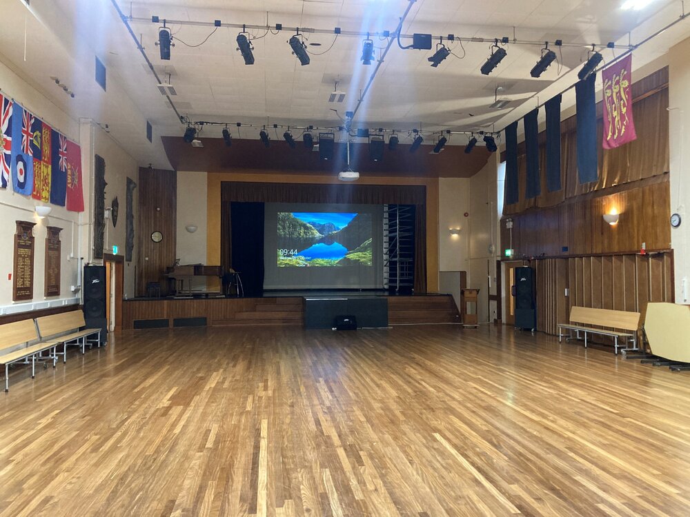

ACTUAL MESUREMENTS! this is projection is 4.2m wide 5m diagonal. so 196" diagonal this pic is from the back of the hall 25m from the screen.
This is projected onto regular cloth, so were loosing a lot of brightness, I grumbled to management but oh well. it still works but could be much better.
