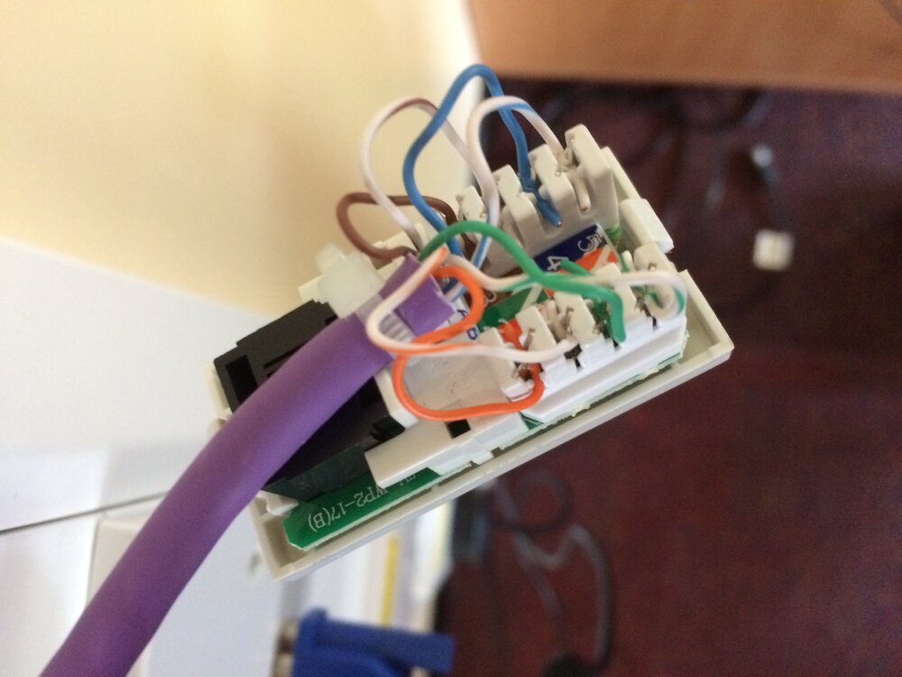

So, I decide to see what the problem could be by first opening up the network socket...

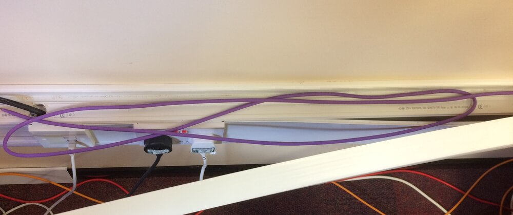

Now, you know it could still work I guess, but the thing that surprised me was that the cable was purple and I knew the original runs were a heavy duty black cable... So, I followed it through into the adjoining room pulled out all the desks and filing cabinets and opened up all the trunking... I guess they had some spare cable!

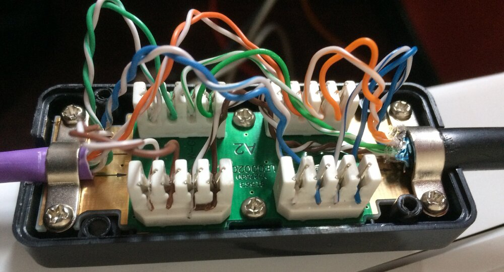

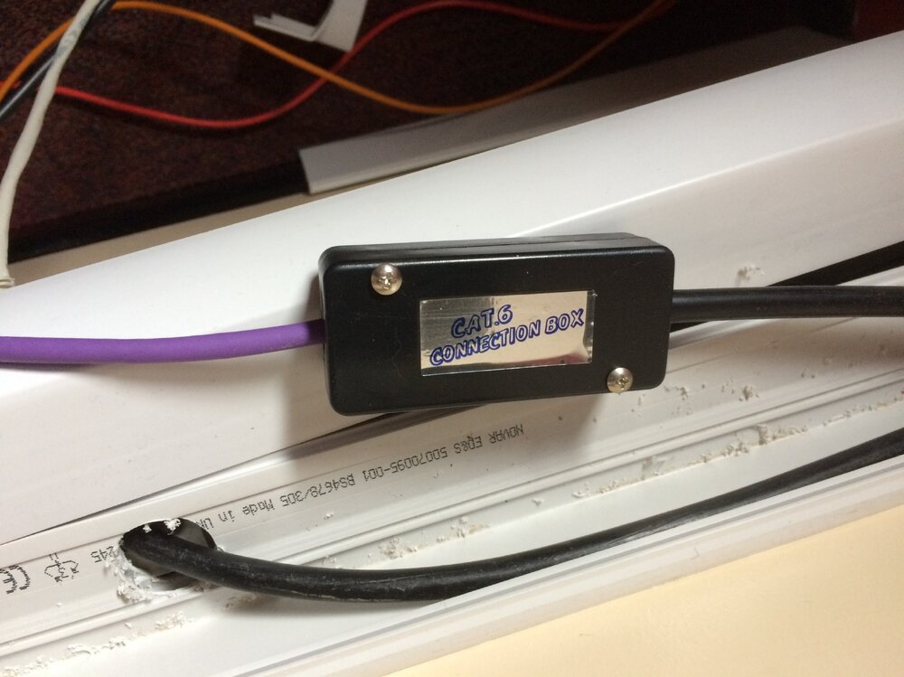

And yes, you guessed it, this is what joined the purple extension and black original run cable...
Punched in with as much care and attention as the wall socket...

Yeah pretty sure when I've used those connectors you have two sets of 4 on each side - side A is one cable, side B the other cable, and they've put half of A on B, and vice versa. Surprised if a single one works if you run a tester down the entire run!

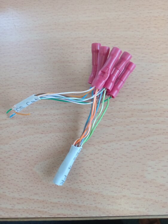

Oh dear, at least they attempted to use a coupler, I found a cable that had been twisted togeather and taped with electrical tape once :(
How well did that work? (asking for a friend)
I found the old twist-and-tape method in a couple of our maths classrooms after they re-did the ceiling recently. It had been working fine for at least the last decade!
