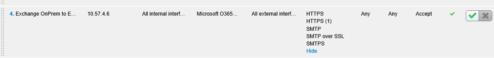

Yes going through Smoothwall Box, Port 25, 465 and 587 (as well as HTTPS) all open to Exchange Online IP's from our on Prem exchange box.
Screenshot for firewall rule and queue attached...

Think I might have found the issue, if I try and telnet to "our-domain.mail.protection.outlook.com", I get redirected back to our Smoothwall UTM box on ESMTP Anti-spam!!!
I'll try turning off the anti-spam and relay before sending out again after changing the MX record...
