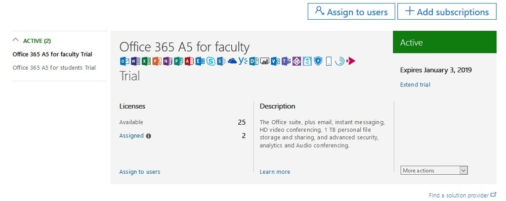

2) I do have an O365 tenant set up... May well have done a few bits wrong as it has not given us A1 licenses (and to be fair I don't want A1) it does however appear to have given us a trial of 30 A5 licenses! There are a few bits in the Tenant I cannot set-up as the Domain I used does not have a website associated with it and therefore I think I skipped the part about DNS and Exchange and all the extra bits (bearing in mind this is to get one app on one device for one user)... I also haven't added a credit card and the website crashes but first gives me a message that I don't have permission to add subscriptions when I try... contact your admin...

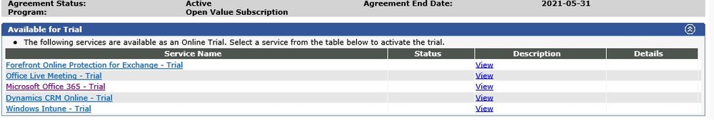

I have looked for a way in VLSC to add any kind of O365 licensing but from a Google search, I don't have what I need to activate it. In the other thread I was told my reseller would be able to do it for me...

Ok, so if I understand you correctly, as I have an OVS-ES agreement for Office ProPlus I can have O365 Pro Plus put on to my agreement on MVLSC for 'free'.
I presume this is something my reseller does as that is basically what I was told in the other thread.
I need this done (I needed it done 10 days ago when I figured out this was the only way to get Word on an iPad for my Headteacher), however I am not getting any response from my reseller (we are halfway through a licensing period and not due for renewal until March/April) - hence this thread.
Edit: @sparkeh - Sorry, I didn't understand the relevance of the MSI question... We have a very small estate and everything is installed manually by me going round using a full iso of Office on a disk or USB stick!
