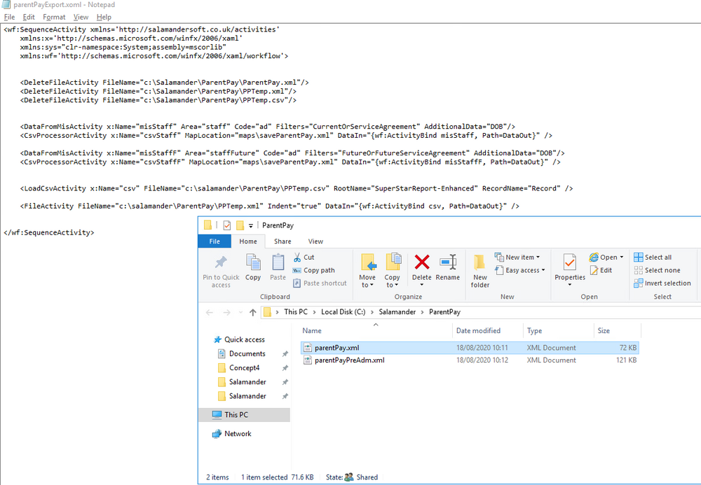

howartp Posted August 18, 2020 Posted August 18, 2020 I completely agree it should be automated directly, but we do this with Salamander generating the XML file then using MIS:Sync to upload the XML - which I think the finance/kitchen team can do if I choose to let them. Saves the manual entering step at least, and ensures you get the correct matching IDs from whichever system you're matching to. Peter

howartp Posted August 18, 2020 Posted August 18, 2020 Wait. What? Did you just say that Salamander can generate a file that you can import using MIS:Sync to partially automate the creation of staff in Parent Pay? I believe that's what I said Ask your support guy to copy code from South Craven. Peter 2

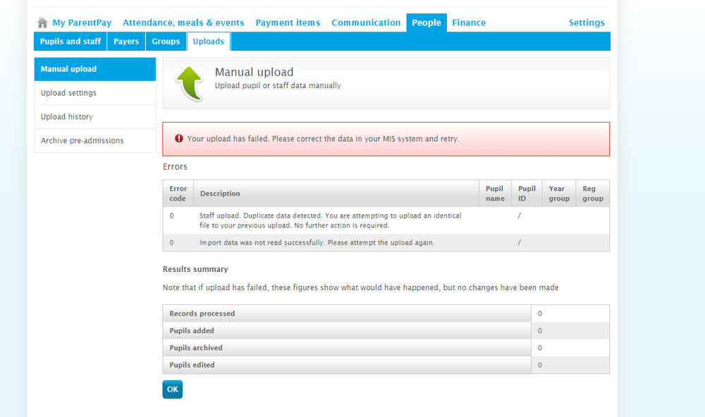

MicrodigitUK Posted September 25, 2020 Posted September 25, 2020 I believe that's what I said [ATTACH=CONFIG]58874[/ATTACH] Ask your support guy to copy code from South Craven. Peter @howartp Could you give an example of the headers and fields in the XML import file? Obviously redacting any user data, just need the XML file format. Got Salamander to set this up for Staff at our site but... I have tried using the output XML file and MISSync is telling me there is nothing to import! Do you need to upload it in a different way?
howartp Posted September 25, 2020 Posted September 25, 2020 Log on to ParentPay > People > Uploads and upload it manually. MIS:Sync often tells me there's nothing to import, even with a perfectly valid file. Peter
MicrodigitUK Posted September 25, 2020 Posted September 25, 2020 @howartp I have also just tried that however that also gives me an error. Please can you give an example of the XML file headers and format so I can check Salamander are outputting the data correctly in the XML.
howartp Posted September 25, 2020 Posted September 25, 2020 PPSample.xml This is copied straight from today's file, stripped to 1 staff and suitably renamed. MIS:Sync doesn't like either this or the original, but online upload has accepted today's file. Peter 1
