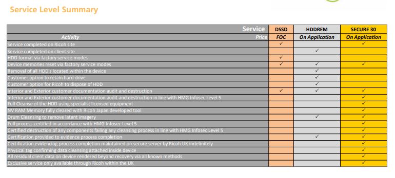

I have just got this from our Ricoh sales person...
Re-format of device HDD via factory service modes
• Device memories cleared via factory service modes
• Residual paperwork removal
FOC
HARD DRIVE REMOVAL ON SITE
FOC – AS LONG AS RETURN DEVICE WAS INSTALLED POST NOV 2012
SECURE 30 - £245
