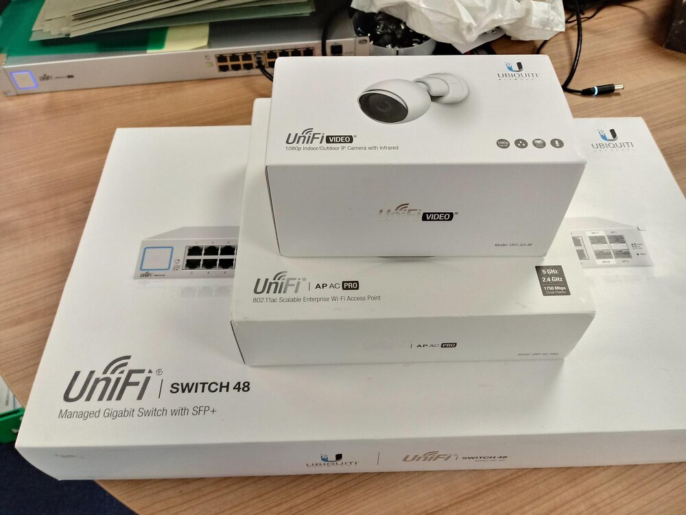

I went to visit @richbrowncardiff as I heard he was wholly embracing Unifi stuff and his school is one of the top rated in Wales (Currently rated Excellent, and with Excellent prospects for improvement, which is fairly unheard of in South Wales).
So now am looking at replacing my 45 Cisco APs with Unifi, installing their CCTV cameras instead of our hideously overpriced and underperforming contractor system, and also replacing some of my HP switches. (mixture of 2530 and V1910)
First impression are great, the stuff is good quality - the Controller software and interface is fantastic, like a breath of fresh air after using command lines or HP web interface. Also - HP have been going backwards as far as I am concerned, more expensive, worse interfaces, rebranding cheap stuff from other manufacturers (3com?!!).
Will be buying some targeted unifi kit to get a couple of areas more POE capacity and upgrade the links to 10Gig over the next couple of months.
