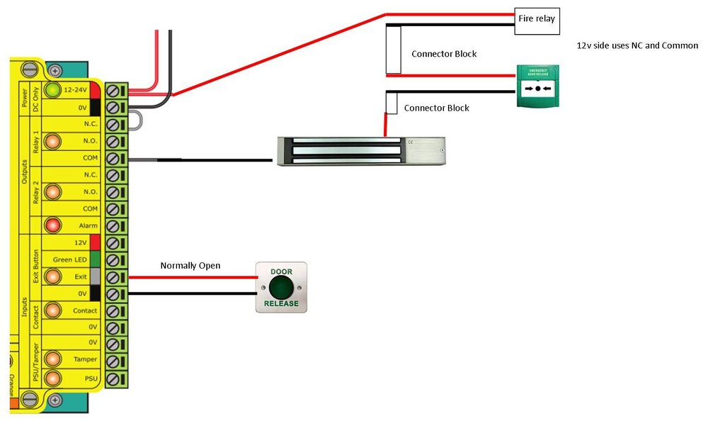

Basic diagram, I'm no professional and I've not seen a professional install but this is how I did it and it works - information on wiring this up is pretty scant online and the Paxton instructions are vague.
I basically bring back a wire per device (one wire for maglock, one for fire relay etc.) and connect them up inside the net2 - keeps it tidy and leaves plenty of service pairs. Keypad is colour coded so you can't go wrong with that.
Hardest part really is routing the wiring
That's a useful diagram, thanks!
