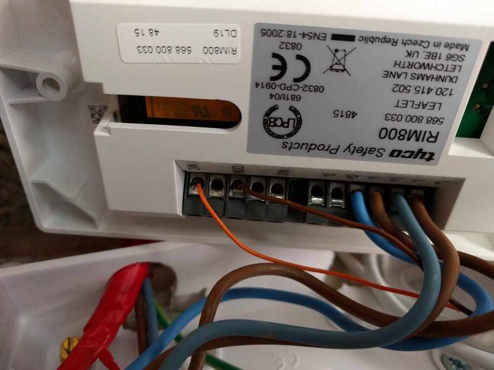

Looking at the diagram for the XP95, you just need the NC and COM from it, probably relay 1 should do the trick. When the site team do a test you will soon know if it works :)
Here's a pic of inside of our relays
orange and brown are to the paxton
