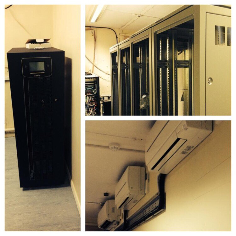

Probably over kill for your needs; Our main data centre has a
30kva Riello Multi Sentry UPS's with extended batteries.
Probably about 40 devices, inc firewalls, switches and servers/San's basically 4 x Prisim PI 42u cabs probably 80% populated on each.
Multi Sentry
From the construction phase
[ATTACH]41602[/ATTACH]
Paid 5k for it but about 7k in total after having all the electrical work done (bypass switches, etc)
Aww its a baby!!! We have its bigger brother in our office here a 60KVa one and its got a lot of racks on it :)
