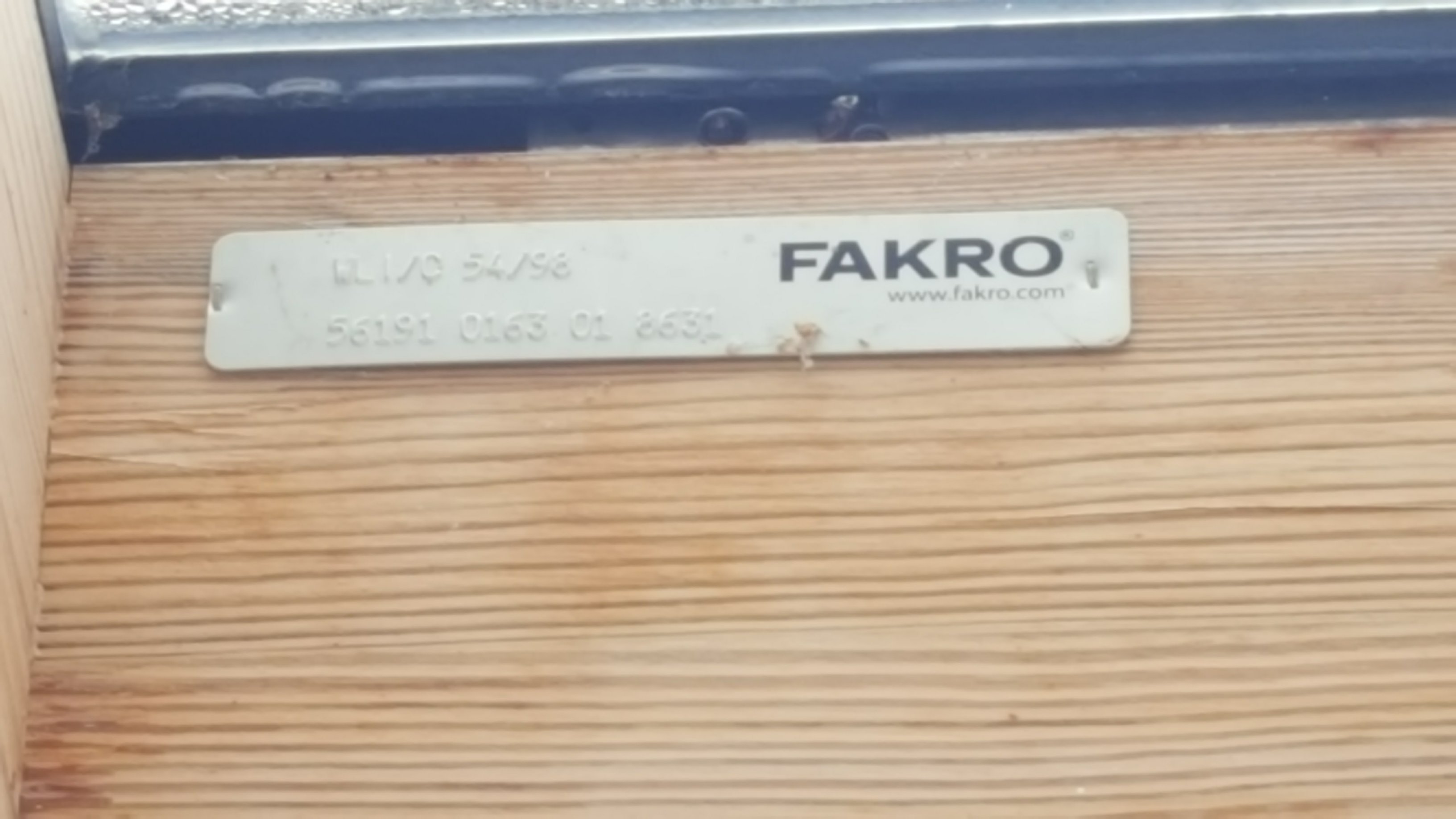

@abillybob - Is the skylight you can reach noticeably colder to touch than other windows in the same room? If you know someone with an IR camera you could take a look with that as well from the outside and see if the skylights show warmer than other windows for example. If it's the WLI or WGI model range and not the FWL/FWR it would appear to be single glazed, so I'd check the model (if there's a number on it), or look at the glazing unit itself, it should be fairly obvious if it's double glazed.
Here what the piece of metal says on the window if that makes any sense to you... :/
We got told by the estate agents it was double but I haven't looked at it properly. It's quite hard as it's recessed a fair amount into the ceiling!!!
[ATTACH=CONFIG]39532[/ATTACH]
It looks like that's single glazed.
Oh cr*p. That's annoyed me a little!! Do you think a double glazed window will fix this issue then? How much money is it normally to get someone to install a new double glazed skylight?

@abillybob - http://www.fakro.co.uk/att/LOCAL/GB/catalogues/FAKRO_roof_windows_product_selector_and_price_list.pdf listed in there under WLI, specifically mentions single glazed hardened. Looks like they're meant to be used in lofts where there's normally already insulation between main house and loft. Cheap way of doing things, and I don't think if it was done like that nowadays it would meet building regs. Out of interest, when was it built/work last done on it?
