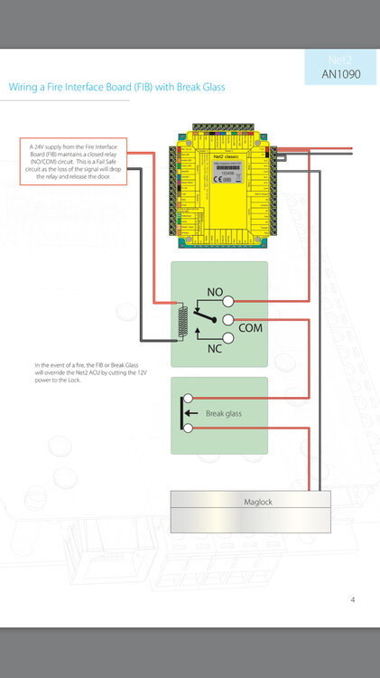

My contact said although the fire alarm is connected to a net2 controller it is reliant on the server software running but the doors should be connected to what is called a fire IO unit so when the fire alarm trips the magnets on the door release.
Hope this helps.
When you say old door, do you mean if the system is being installed onto an existing door as opposed to a complete new door and Paxton system?
Edit: I think I understand. By new door, you mean new Paxton installation?
Yes that's correct. However I asked if we had an old system and I replace it with a new one do I need to link it into the fire alarm. The answer was as long as I only change the controller and the reader and I don't touch the lock, exit button or break glass it still meets the old regulation.
The Paxton controller can link to the fire alarm to sense when the alarm goes off this will send the alert to all other controllers and tell the doors to open.
However the correct way to set it up is to have a normally closed relay from the fire alarm and link it to the live on the door lock. So that when the fire alarm goes off it cuts the pose to the door lock.
You can use Paxton compact relays to do this. You can also wire it so that if you have a fail secure lock when the fire alarm goes off it will put power to the lock to make it open.
