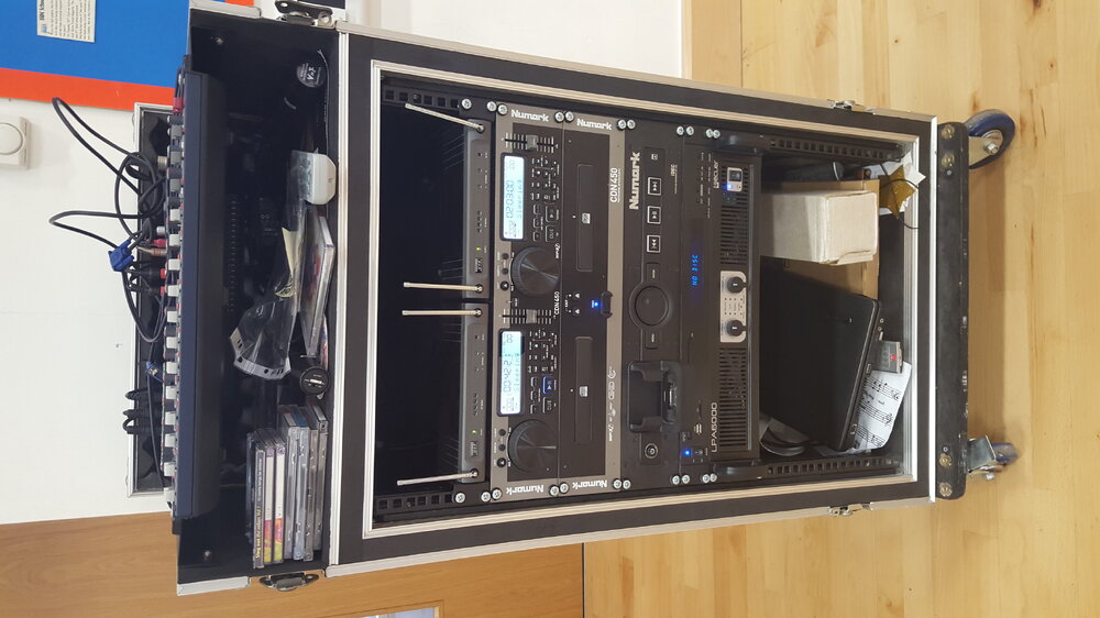

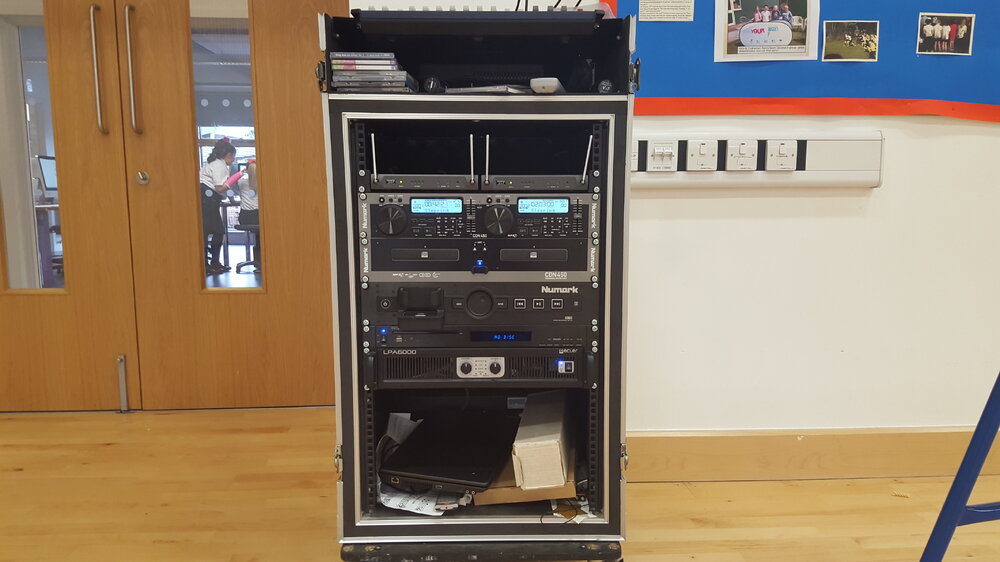

Arreks Posted November 24, 2015 Report Posted November 24, 2015 Do you have any kind of audio/visual system in place already in there? do you have speakers/amps?

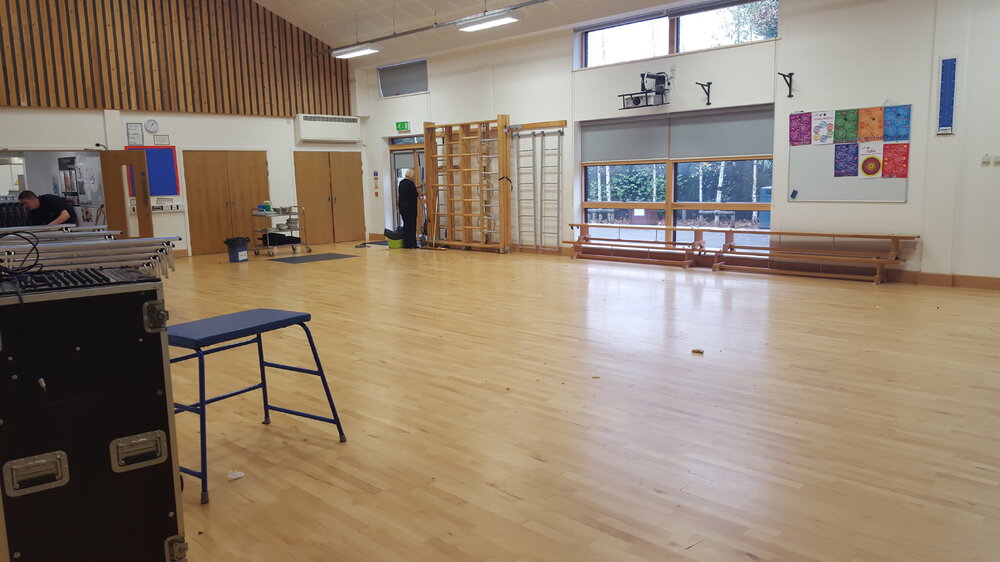

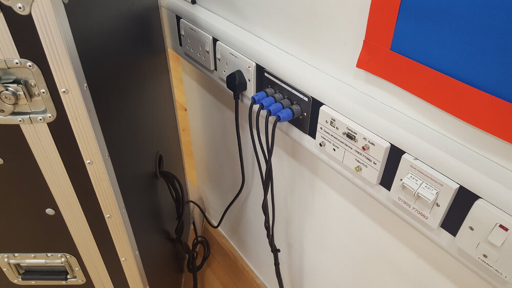

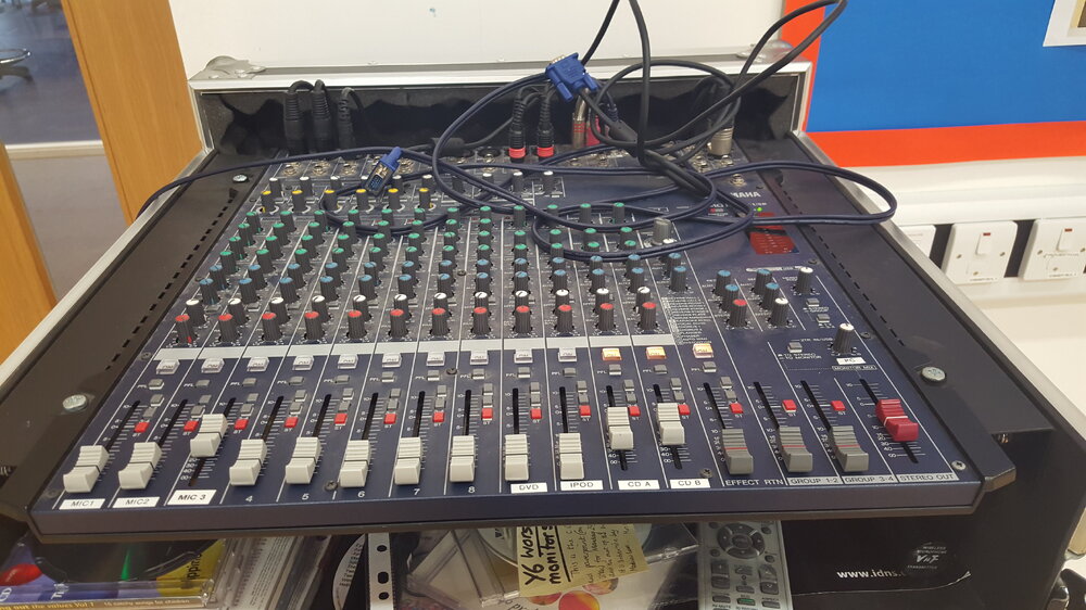

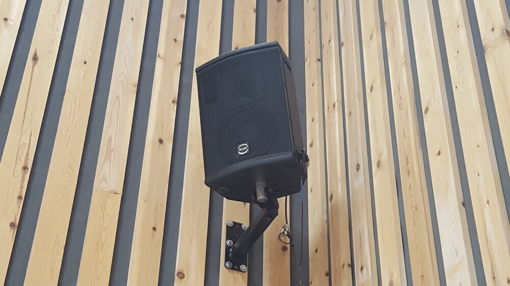

abillybob Posted November 24, 2015 Author Report Posted November 24, 2015 Are you after a company to sell you some microphones, or a company to come in, setup and operate microphones for an event? A company to come out, maybe have a look at the hall and be able to sell us the Mics that they'd recommend. You are asking for something pretty much impossible. Your best bet would be something like an AT Pro45 hanging mic for use onstage. The kids would still need to speak up. We used to have 4 installed permanently and then sub-mixed independently into the main desk. You could call my old company CPS who will be able to advise you. Sound, Lighting & Audio Visual Equipment Sales & Hire 01202572000 I knew it'd be fairly difficult, in all fairness though it wasn't me who wants these I've just been given the task to sort it by next friday... I mean seriously!! Thank you I'll give your company a call and see what they say!! Do you have any kind of audio/visual system in place already in there? do you have speakers/amps? Yeah, we currently have 4 speakers already mounted... well to be honest I don't have enough of an idea of what it all is. I've taken pictures of it all below as well as a picture of the size of our hall.

robk Posted November 24, 2015 Report Posted November 24, 2015 The problem here is going to be gain before feedback. That looks like a relatively small Hall with reflective hard surfaces all round. I would be looking at either using hand held radio mics (guessing that one is out) or maybe a couple of large diaphragm condenser mics, but if the students are not loud anyway they are not going to work.
