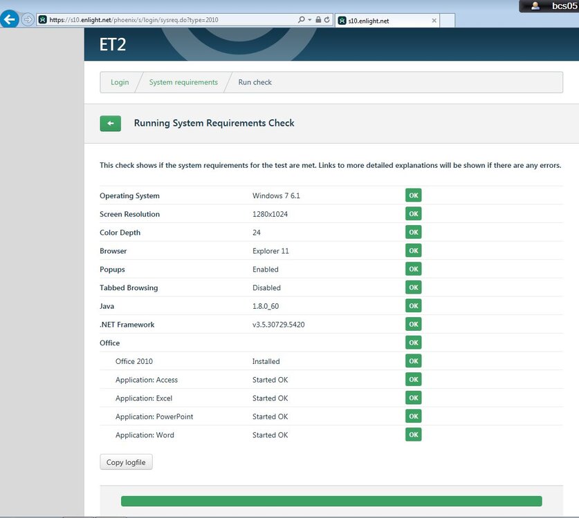

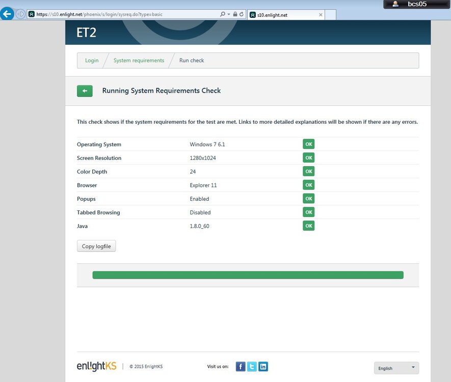

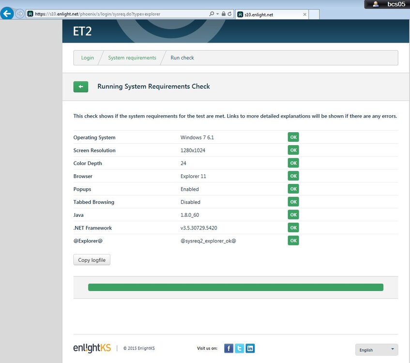

Well it seems that they haven't quite managed to get Java out of the way, I have ran all the tests from their website and I get all green ticks (see pics):
As you can see all seems well!
Well you would be wrong because when the student user logs into the website it runs the same test but comes up with "error" in red on the plugin, when you click help it goes on about a plugin not being installed!!
