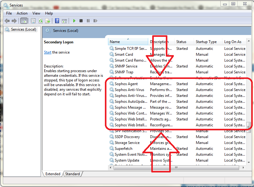

From services stop all the Sophos Services from running and try again
Control Panel --> administrative tools --> Services or from a command prompt running as administrator ( right click on command prompt --> run as administrator ) or run or where it states search programs and files type services.msc and press enter / return and scroll down to Sophos and right click and stop all of the Sophos Services.
Close down all instances of web browsers so IE / Chrome / Firefox etc and re launch and try again on a wired connection and a wireless connection
Screen Grab from machine :
If you need to get sophos started again just restart windows and the services should auto start again so you don't have to start them in any specific order with error messages etc
