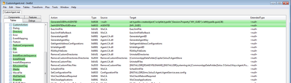

I took a different approach - I made an MST transform file which sets the properties needed by the SOLUS agent MSI directly to the properties table. The tricky part was generating the GUID - I used an MSI custom action to generate a GUID, then another custom action to set the AGENTID property in the MSI table.
Hi jinnantonnixx, please could you advise what the action was that you used to generate the GUID within a MST?

You might not need this any more, but nevertheless it might be of some use.
I used the free InstEdit software to create an MST transform file (never edit the main MSI directly), but I guess the principle is similar whichever editor you use.
By the way, I've abandoned this for now as I couldn't get SOLUS to work across different domains when I last tried it.
Edited by jinnantonnixx

@ohickmott
[ATTACH=CONFIG]33612[/ATTACH]
Could you explain a little more on what you customized all together in the MST file? I'm looking to roll out the Solus agent to around 50 machines at a school and the instructions in the OP unfortunately don't work for me :(
