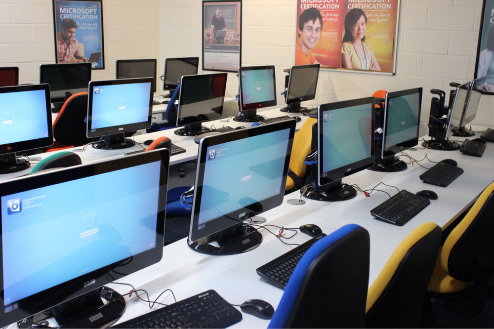

We've been using AIO machines for the last 6 years. We've had 70 or so Viglen machines, now mostly retired, and about 80 HP AIOs as well. They've served us well, and will continue to be our form factor of choice I reckon, as they take up less desk space and stay a lot tidier overall.
